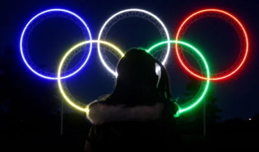

Oh and this lamp was originally at the YVR rings in this position (Red Dot).
In real life the rings were 5 stories high.
