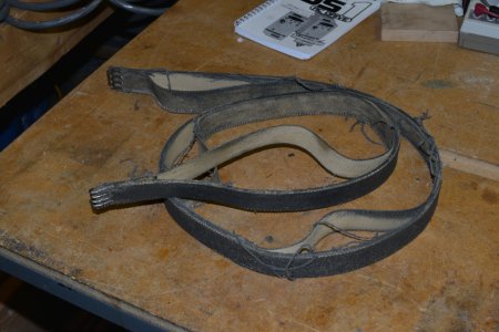

About 10 years ago I pulled off the canvas/leather belt tied with a link fitting. On a SouthBend Heavy 10L the casting is in the way and so the drive belt has to be separated and threaded through the casting slot.
The old belt was in pretty sad shape. The replacement grooved belt is stitched together with MIG wire. The stitching is now starting to fail as the wire work hardens.
