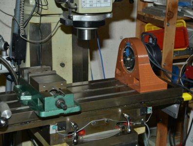

Project #42 which still requires casting the pattern along with the cast face plate for the ER40 collet chuck mount (also to be cast) is not yet complete. However I can make the motor turn in the simulated mount with LCNC. Adding that 4th axis to it was just adding the PIN definitions for the motor driver (STMBL in this case).
