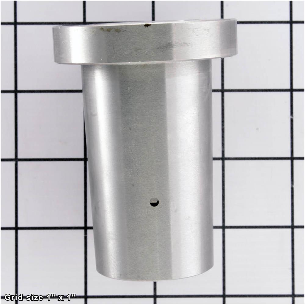

Hi Folks, looking for this adapter for my new to me lathe I also need a drawbar is anyone has anything thats surplus the'd like to sell!
Rauce
What size taper is the spindle?
I bought MT5 to 5C sleeve and a drawtube for the lathe I’m rebuilding but I’m thinking about just getting a 5C chuck instead.
The draw tube is not finished, just a plain tube with the right threads on the end. You would need to add a handwheel.

I'm thinking about making one of these for myself as I need one as well. Do they need to be ground in, or could I get away with strictly lathe work?
Otherwise, Grizzly does sell these also.
Rauce
The one I have is turned. I don’t see the same one on eBay anymore but the seller was making them on a CNC lathe.
To make one yourself, I would only rough in the ID features at first, turn the MT and then finish machine the collet seat in place.

I have it as a project to do. Turning it on a lathe should not be a big deal. For me I have taper MT4.5 so either I have to be a bit off by using MT4 as template or try to set the compound to MT4.5 angle and hope the angle I found for MT4.5 is indeed correct.
Doing the 5C part should not be an issue at all - I did ER40 and it worked out great.

There's some on ebay so thats definetly an option The Grizzly one I'm seeing questionable runout so it would probably have to be indexed and ground in. I'd make one but my list is already ridiculous, starting with a cabinet / bench to put the new lathe on : ) I'll wait for Rauce's reply : )

You can use a test indicator in the spindle bore to get the angle for the compound.
I’ve done it before, although with an external taper, to make chuck backplates.

Yes, good idea - I can just measure the angle from... what I have!
Main problem will be actually seeing the indicator - maybe I use extended leg.

Yes I guess you would need a test indicator with a longer probe. I have a mitutoyo one that would probably go 2” in while still being able to read the dial.
The other thing is getting the tip on center. If you have a tool height standard I think getting the ball on the probe lined up by eye would be good enough.
