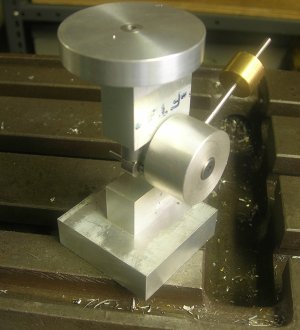

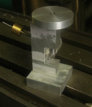

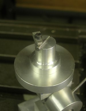

Here is a lifting device I made ages ago based on a design that appeared in Home Shop Machinist or maybe Live Steam ages ago. I've never found better. No force of a spring to overcome and while very light to start with, there is a counterbalance so you're not applying force to overcome gravity. The most sensitivity comes from trying to get to a zero force motion, this comes very close to that. I can't remember the designer, but kudos to you!
Very simple to make and it works really well. For fixturing, masking tape works well and I did make a mini v block that sits on top.
Does the table turn on that lifting rod? Is that an advantage or disadvantage?
Yes, its not keyed, but I can't say I ever thought about it (although could be) There would be a slight bit of friction between the bottom of the post and roller stopping it from turning I guess. i use I've either taped the work to the table or hand held it like the little V block and look in two directions to centre things
Another table question, press fit or threaded on the lifting rod?
The brass counter weight is a nice touch.
either or, or loctite. Can't remember how I did mine it was so long ago. I was probably more hung up on super accuracy in everything I did (now its just where it needs it) so probably was press fit .....today for sure it would loctite lol. Which ever way, afterward put the shaft in a collet and face the table top and it'll be perfect
