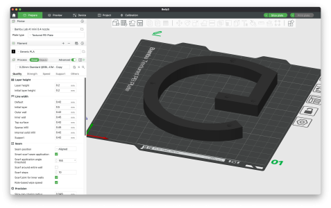

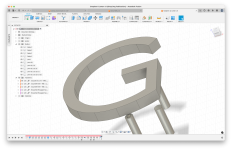

Here is a letter G house number with standoffs. Designed in CAD the 3D printer (at least not the kind I can afford) can't use that file to print a part directly. It needs to be converted in a two step process.
The first step is to convert the CAD model into a file format, (.STL or .3dMF) which a 3d printer utility software package can import. That software is nicknamed 'a slicer' and includes BambuStudio, Prusa Slicer, Cura, and there are others. The slicer software creates the instructions the 3d printer can follow by parsing the 3d model file.

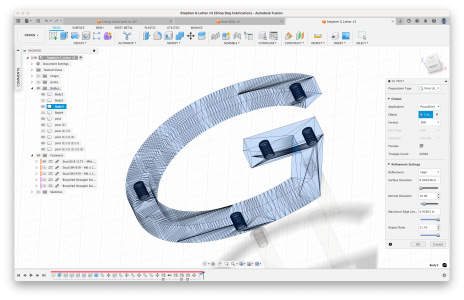

The 3d model file, .STL file, is a representation of your CAD designed part but converted entirely into triangles. It is a raster type file from your vector cad model. It looks like this when created, viewed, in Fusion 360.
See all the triangles? You can see there are various output adjustments for resolution and such. The format does not support curves directly, curves have a stair step appearance which can be minimized by increasing the resolution (making a lot of small triangles) which of course makes the file bigger, requires more resources etc. no surprise.

Here is the G loaded into the slicer. See all the parameters, 5 tabs of parameters. How many layers of plastic do you want on the sides, top and bottom of the part? 2 on the sides is default but you might want more for strength. How dense should the inside be? Solid like wood? Or less like cardboard? 15% grid is typical but you might want more and maybe a lot more. The more you add of course the stronger the print and the slower it prints.

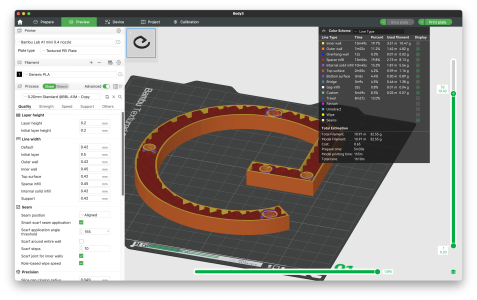

Here you can see the inside of the part sliced with 2 perimeters and 15% infill.

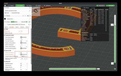

Here I have adjusted the parameters to have more perimeter layers putting a lot more meat around the screw holes as well as the part edges. And I changed the infill pattern from grid to honeycomb. Finally I changed the nozzle from 0.4mm (standard size) to a 0.8mm nozzle. The 0.8mm nozzle puts down a lot more material in the same time period, big fat lines of filament, at a cost of reduced resolution and quality. This means the print time only increased by 20 minutes instead of doubling despite printing more perimeters and such.
