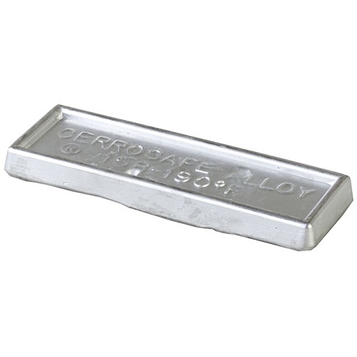

Use cerrasafe - you melt it like solder and pour it in on top of a cloth plug. It shrinks when it cools and can be removed. Remarkably, it then starts to expand to the original diameter after so much time. It also comes with a time chart to calculate expansion vs original bore. Then you can measure the casting with a standard micrometer. It takes time to use cerrasafe but it's an amazing solution. Highly recommended. My favorite.

Cerosafe shrinks for a few minutes after hardenening and then returns to the pour size. Does sulphur do that too? Cerosafe is readily available from many sources, is very easy to use, is very reliable, and is consistent. So I confess that I'm quite surprised by your use of sulphur instead.

I am pretty sure it's a mechanical response because it is very time sensitive and the material would have temperature stabilized almost right away. It keeps changing days later. Here is a quote from Brownells for the curious.
"There are various products on the market which can be used to make a cast of a chamber. To be certain that the product we are offering you is the best and most practical, we contacted the basic manufacturer. They recommended Cerrosafe because of its unique features. Unlike Woodsmetal which swells upon cooling and cannot be removed from a chamber, Cerrosafe shrinks during the first 30 minutes of cooling and then at the end of an hour, is EXACTLY chamber size. At the end of 200 hours it will have expanded approximately .0025'. This factor is well known by all toolmakers and they will take it into consideration when making dies or reamers or gauges from your cast - if you will tell them the cast is of Cerrosafe. Cerrosafe melts between 158° - 190° F. It should be melted in a clean, iron ladle. Source of heat should be removed as soon as the alloy is completely melted, at which time it is ready to pour. The solidified casting should be removed from the chamber before, or when, it cools to room temperature. If allowed to remain in the mold over an hour, it will grip the chamber walls and be difficult to remove. Clean the chamber thoroughly, then plug the bore immediately ahead of the throat with a small rag - but not so tightly it cannot be driven out. If possible, pour the molten Cerrosafe through a small tube into the bottom of the cast, gradually removing the tube as the chamber fills. If the chamber is cold, warm it to room temperature or above before making the cast. When cooled, remove from chamber, using a rod or dowel from the other end. "
Here is a link to the Brownells product page.
It is available in a Canada from
And here is a photo of the expansion rate information. Note that this is inches per inch. Also note that it is all done expanding after 200 hours. I like to remove it at 30 minutes and measure at 1.5 hours. If I miss the 1.5 hr window, I just let it sit for two weeks and then calculate the change based on 0.0051 per inch.
