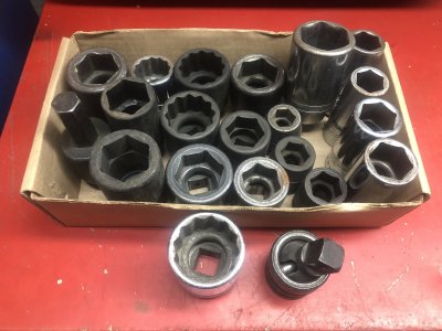

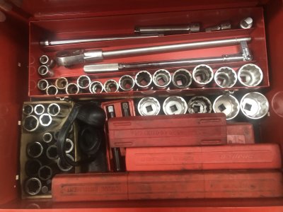

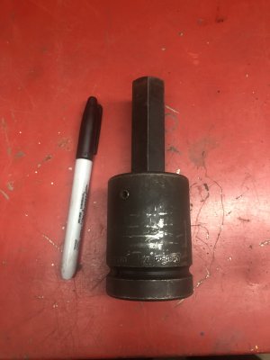

7B445FA3-9420-4DD5-8D8A-2DB6BED9F852.jpeg Bunch of 3/4” drive sockets on Kijiji. Paid $550, the universal swivel is $200 by itself according to the website. I figure there’s about (new, truck money) $2300 sitting there. All Snap On, some barely used. It was local and what I figured was a deal
I’m happy anyway
