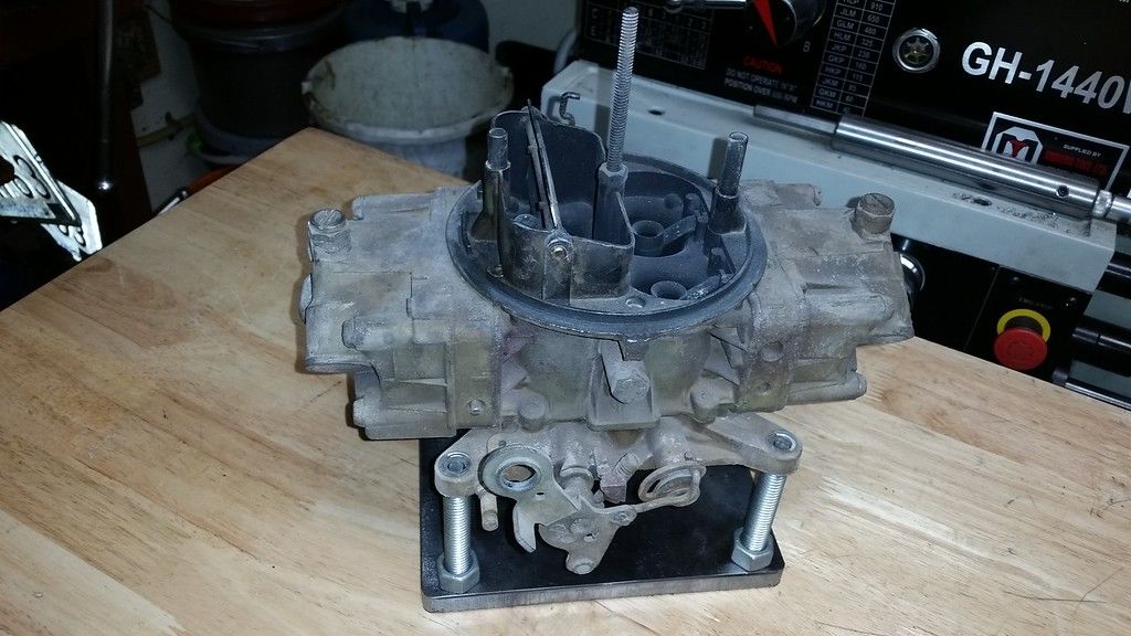

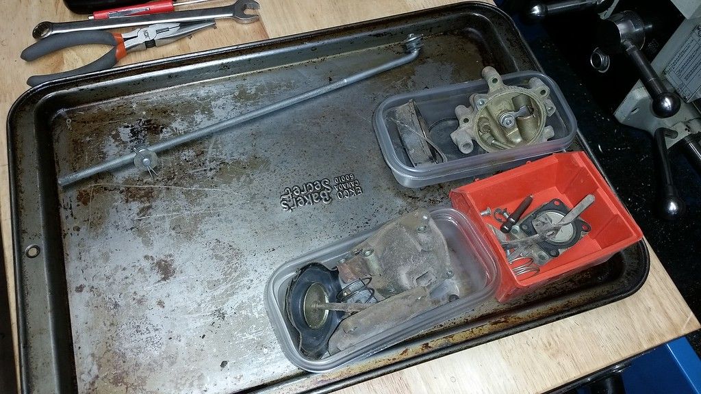

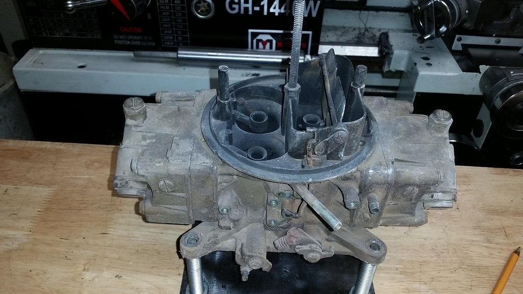

The L79 327 came from the factory with a Holley 600 CFM carb and an aluminum intake manifold. Somewhere in it's life this engine got an Offenhauser intake manifold and the 780 CFM Holley that started life on a 1965 Chevelle Z16 396 big block.
I picked up a rebuild kit for this 4150 series dual fuel inlet carb. It's a liitle odd as it only has 1 accelerator pump and has vacuum secondary venturi control. The sales guy at Mopac said this kit has enough parts to do a 4150 or the later style single fuel inlet 4160 carbs. I hope he's right.

I had a 327 with the offenhawser spreadbore intake and a 650 holly spreadbore with vacuum secondaries we found the 750 was too much for it.
