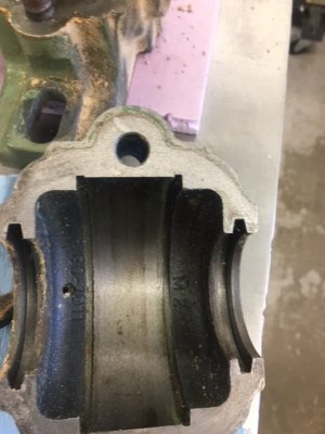

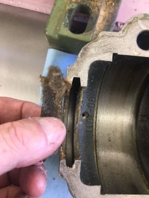

In my other thread ('borrow a gantry crane'), I mentioned 'pillow blocks'.
Not really a 'pillow block' in a modern sense, but the two large bearing holders in this photo are marked FAG, and hold the 1210K double roller bearings. I would seem that the 1210K's are not original to the FAG bearing holders and have been retrofitted by someone at some point in its life with an attempt to manufacture some collars to hold the bearings in place. The FAG bearing holders(pillow blocks) also have felt dust seals and also appear to have been an oil bath container in the past. The FAG bearing holders seem to be original, and a 1932 mfg date would put it in the era of roller bearings and not Babbitt bearings AFAIK - altho I wouldnt be surprised that babbitt was still in general use until after WWII.

I would expect that it originally had babbitt bearings unless this was a Cadillac of jointers. "In the era of" does not mean everyone had switched over. The shop I worked in 40+ years ago still made some things with babbitt. Mind you, some of the machine tools themselves were converted from line-shaft and were maybe WWI vintage or perhaps older.
Is the cylindrical head original, or was it upgraded? Machines that old were serious amputation traps with their triangular cutter heads.
I literally said "altho I wouldnt be surprised that babbitt was still in general use until after WWII."
