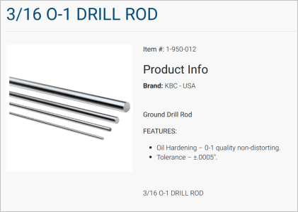

    Can you elaborate on what rod you sourced? For example if its drill rod, they are typically ground with stated tolerance +/- 0.0005" My...

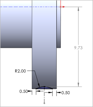

    If I use your R=2.0 mm and 0.5mm offset on both edges, I get a resultant distance of 9.73mm from the center of groove to axis. So 2 *...
