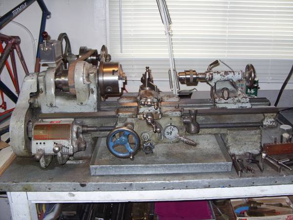

There are certainly better lathe drives out there, but speeds are quick to change, and a little belt slip now and then can save a lot of damage in the hands of a newbie. ;) Around here it's not too often that a lathe small enough to man-handle into a basement, and comes with a wide range of threading options, power feeds on both longitudinal and cross feeds, threading dial, and enough tooling to get started. I've had fun with my little South Bends, and if I decide to change brands it will be because I am looking to add more Canadian content in my shop....
How are you liking your Standard Modern? Are they loud, being gearheads rather than belt drive? I keep thinking I want to make the switch, then I start thinking about what I have collected for my South Bends and I get kinda wobbly in the knees and have to sit down for a while....:D

Thanks for your evaluation, they sure look beefy in comparison to the South Bends. I am going to have to start selling off some lathes to free up some space and play money, if I decide to go that route. It would be awesome if the nos taper attachment I have been storing for a decade or so happened to fit a SM........ Of course, if I stick to the South Bends, I have a lifetime of spare parts already in stock.... Lol
