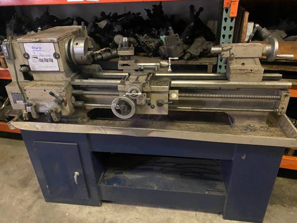

Ad says "low gear is stripped" but for $500 it could be a decent deal. It's one of the generic Taiwanese machines so gears shouldn't be to hard to acquire.
wow, that's an amazing price! "Mostly used for polishing" makes me concerned for the ways though.

how do you check the ways? I mean if it is really pooched it is easy to tell. but if they have just been 'sanded' out of shape I don't know how to figure out how much in trouble I would be. I sent a message but am not holding my breath as I can't rush out there.

About the easiest check you can do is bring the carriage up fairly close to the chuck and gently snug the carriage lock, just enough to add a slight drag, then slowly wheel towards the tailstock. If the ways are heavily worn, you won't get far......

This is very good. Never heard of the method before, but makes great sense.
Most of the wear will be near the headstock. By tightening it up at the headstock you remove play at the most worn place. Trying to move it away from the head will take up that play and jamb the saddle movement toward the tailstock.
That's a crazy price! If only it was on the Island. And I didn't have one coming already Friday.
