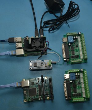

My second cheap Break Out Board arrived this week. At $4 or so it makes for a cheap buffer along with relay. Standard PC Parallel port input. Connected to a MESA 7i92H which talks to a Raspberry Pi4 via Ethernet. The other little board is a CAN bus and RS485 (MODBus) interface HAT. The Pi4 runs LinuxCNC.
I'm putting this project onto one board to experiment with installing the Tormach CNC user interface.

I'm not sure the Pi3 is up to the task but OTOH, I recall that there are a few guys on the LinuxCNC list using a Raspberry Pi and they might well be Pi3s. I'll ask.
from what I can tell they should be similar in performance, its just that its more manual to setup. You will have to get the real time kernel installed then install Linux cnc on it where as with the pi4 you just get the image that already has everything setup.

Andy Pugh, one of the LinuxCNC maintainers posted this as a reminder.
The stock LinuxCNC image might well work, but be aware that the reason
we tend to suggest Pi4 is that the Pi4 has the ethernet on the PCI
bus, not on the USB bus.
atp
Just something to be aware of.
Andy also mentioned this.
SPI (Such as 7C80) ought to work though.
atp
Unfortunately like the 7i92H it's also out of stock and costs $249.
