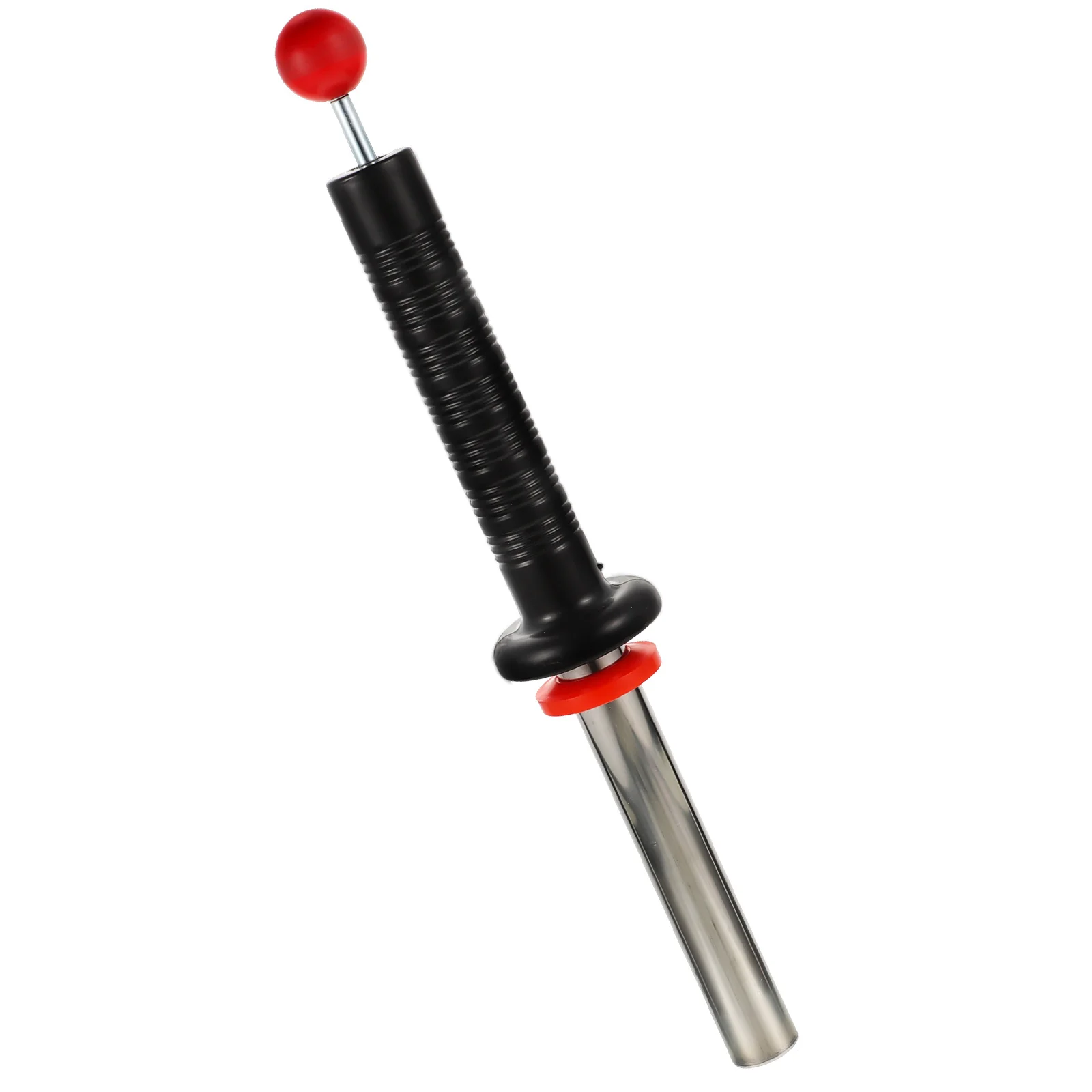

I was over at my friendly neighbors place the other day and he showed me a tool and stated "you really need to get one of these:"
Link-->
Really handy for reaching to the back of the lathe to retrieve swarf and also for picking up from the floor without bending over.
Anyone try one?

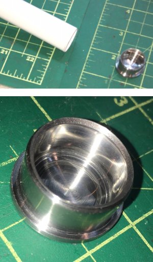

Being the kind of guy that never shies away from a new tool, I decided to make one. I'm going to use a stack of 18mm rare earth magnets, the ones with the little hole through the middle. I just made the end cap, used my new annular cutter arbor in the lathe to make the recess for the magnets, (thank's Susquatch).

I have a nice baby version from Boring Research which is handy with my small machines (no longer available):
Amazon U.S. has one similar to @slow-poke’s link, but for a lot less:
IIRC, Mr. Pete made a large version in one of his videos.
Link--> Amazon.ca
Pretty sure that it was @DavidR8 who told us about one a while back and I got one. I love it. I only worry about magnetizing parts of my lathe with it.
I confess that the price on the one you linked to would have stopped me cold. I don't remember where I got mine or exactly what I paid for it but I know it was no where near even half of that and looked pretty much identical.
BTW, I absolutely love the swarf drop feature!
Too bad it doesn't work on aluminium.

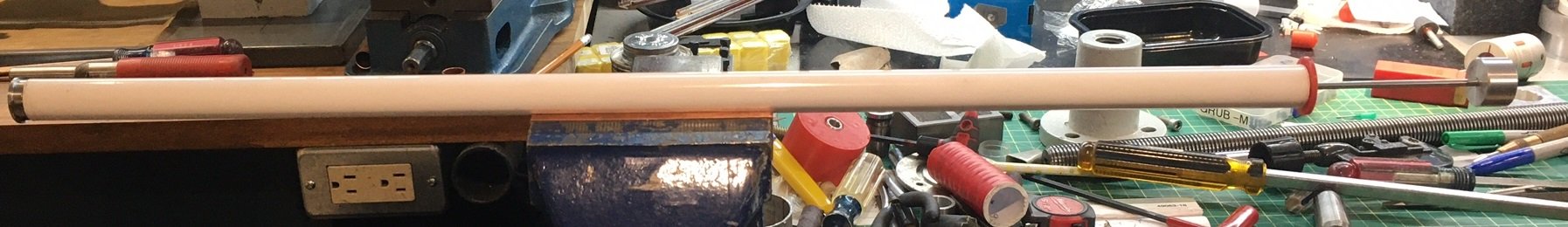

Just waiting for the magnets to arrive. IF the swarf wants to follow the magnet up the tube I will 3D print a deflector cap. Tube is portion of shower curtain rod from bathroom renovation, rod is portion of surplus Ikea cross brace. moving on to project #561.
