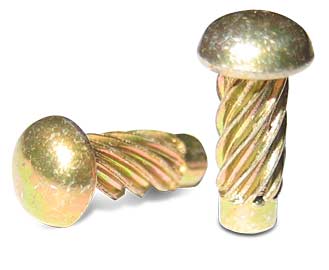

I keep forgetting the name of those thingies you pound in to hold nameplates into machines
TorontoBuilder
I have two sources bookmarked for the rivets that have the spiral thread that are used to rivet name plates to cast iron machines,
But for the life of me every time I go to look to buy more I can't recall what those frikken things are called.
If I ever find out I'd tattoo the name on my ass. so I dont forget
Nameplate rivets?
Or bifurcated rivets?

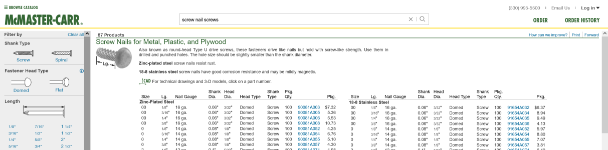

Drive screws!
officially I think.
I think drive rivets is the broader term. There are many kinds of drive rivets and not all of them work well for name plates.
I don't think I've ever seen them called screws. But it's not like I look at drive rivets 24/7.

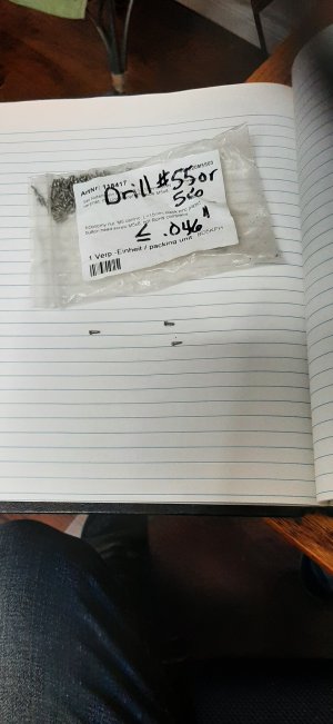

I have a small box of those. I'll look to see what size they are...............................Daniel
