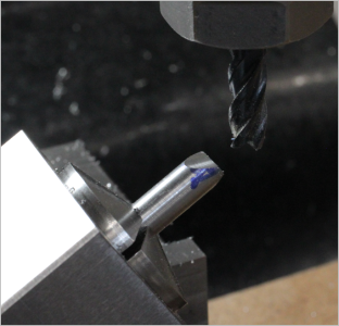

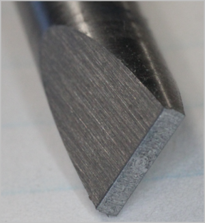

I have to remove screws with extremely thin slots on a regular basis and often I have to grind the screwdriver bits to the proper size to remove those screws.
I use to do it by hand, and then a small 3-jaw drill chuck. But recently I purchased an ER11 collet for 1/4" hex bits from Mari-Tool in the US.

Won't the bits from a Wheeler screw driver kit fit?
Didn't know you could get a 1/4 hex collet!

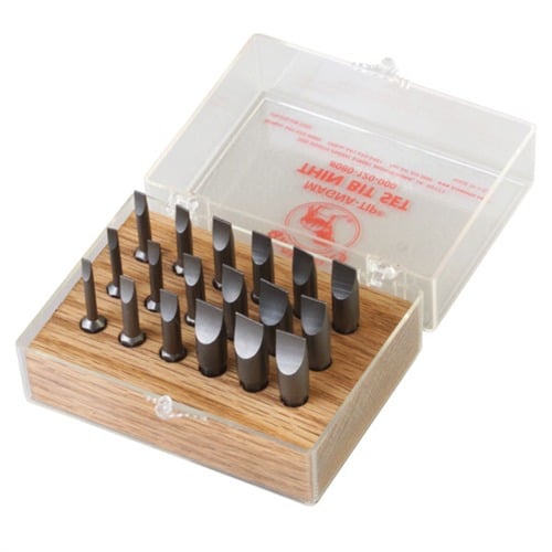

I have the Brownells Master bits, and several of their thin bit sets. That will do 99% of all screws, but the high end stuff like Purdey, Holland & Holland, and number of the Italian manufactures have screw slots 0.010"-0.015" thick, as well as different widths. And they have to fit perfect or they'll get damaged.

I didn't think so either, and then decided to Google it. MariTool was the only company I found that make a ton of odd ball stuff. I had to have it shipped to my brother in the US, and he brought it up.

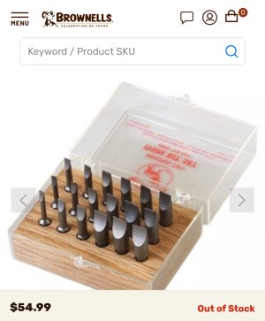

It’s difficult to tell from the Wheeler website, but it doesn’t look like they have the super thin bits that Brownells sells (when they are in stock):
My Master Set & Thin Bit Set were some of the first tools I got from Brownells after Guy Lautard introduced them to me.

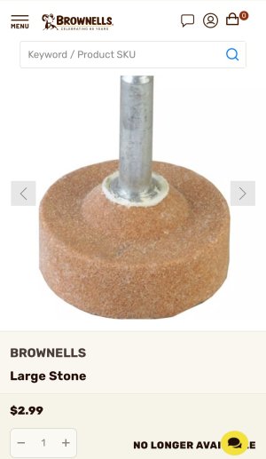

They also used to sell a rotary stone sized for touching up or modifying their bits:
That is a great idea; I knew that Mari-Tool had hex & square ER collets, but didn’t make the connection for using them for touching up my 1/4” (or 4mm?) hex bits: another item moved up in the Wish List!

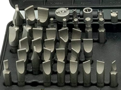

They do, and it's readily available too. They are part of their 89 piece set. All different widths and thicknesses. I've never encountered a screw head it didn't fit. But I don't work on the high end stuff that @thestelster does. I suppose one could buy two sets and grind one set even thinner though.

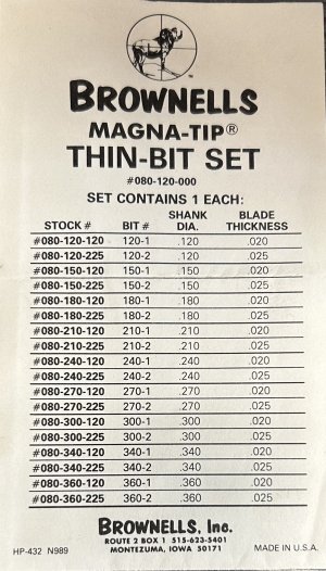

I saw the Wheeler 89 pcs. set, but while some of the flat bits are thin
I didn't see any bits this thin:
I don't know why Brownells doesn't show the sizes on their website.

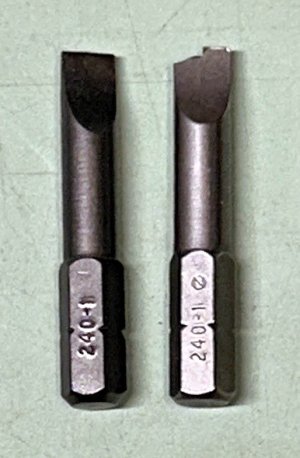

Also, I don't know whether they offer it anymore, but they use to offer free replacements of thin bits if broken during use.
Yes, they replaced one of the 0.020” bits I chipped, but that was at least 20 years ago ( they didn’t need me to send the bit back, but I think I needed to pay postage):
Yes, I saved it: who knows, I may regrind it (after my ER16 hex collets arrive).
