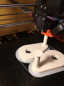

I've printed a bunch of speed handles for the vise. 3/4" hex handle. They work great for positioning the jaw but will break if you try to tighten up much. I reprinted them with 5 perimeters and 55% infill. They are stronger now but you can still break them. I used PETG and then tried ABS. They don't seem much different in strength. Any ideas? is carbon fiber stronger in practice?
