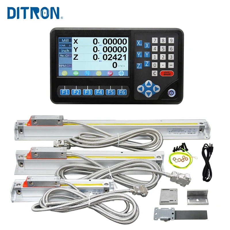

I had problems with my old DRO and was looking for a replacement in October. I wanted an LCD DRO and 1um scales. Despite asking plainly and directly, twice, Ditron (at ditron-dro.com) would not offer anything better than USD $525 for that package. At current exchange rates, that's well north of CAN $700!! Prices on AliExpress were better but not a lot. An LED DRO would have been a lot less but I'm not into 80's nostalgia that much!
After looking at Ditron, I ordered a Sino DRO via AliExpress on October 31 for C$525 (delivery included).
3 Axis DRO Kit:
1 piece Sino SDS2-3VA LCD display, user manual, mounting bracket, power cable, screw bag
3 pieces 0.001mm Sino KA-300 scales, scale covers, mounting brackets & screw bags【70mm~1020mm】
Specifying the scale lengths is mildly stressful. After placing the order, I used the Message Center on AliExpress to tell them the machine travel lengths required for each of the scales. There was no response from them about this. Nonetheless, the package contained the right scales.
I don't have it installed yet but the system appears to work fine in bench testing. The scales and DRO were delivered in one week! UPS charged an additional C$53 (duty $5.22, GST $27.84, brokerage $17.65+$2.29 GST).
My only beef is that the supplied power cord is for Australia and, while apologetic, they basically refused to send me a North American version. The DRO adjusts to whatever voltage and frequency it receives so that's not a problem. I had an old cord with the needed C13 plug so I could make it work.

So what's a much better price people have gotten dealing directly instead of Aliexpress?
Can someone with a Bridgeport J confirm the travel length to spec for a DRO?
I got the information below from here and was just going to covert the units below and add 133mm as per the AX listing instructions:
Table travel: X-Axis 31” (With power feed 30”); Y-Axis 12”; Quill travel 5”; Knee travel (Z-Axis) 16”
I negotiated a price of $600 all in with them for a 3 axis d80 with rpm system about a year ago. Another member got a similar deal. Mine is still in the boxes waiting for 'free time'.
I have a D80 on my Emco lathe and its been great.
EDIT, it was 2 years ago and it was 628 total, all in, after Fedex clipped me 28 bucks.
I got a 4 axis + rpm with 1 micron scales for just under 400 all in plus a customs ding I didn't count on. Say 450 all said and done. But that was 2 years ago.
Here is a post that links to other posts that describes my deal as well as Bridgeport Install details.
This is what I installed on my JHead Bridgeport Hartford Clone. Note that I purchased a 4 axis plus rpm. The box was then programmed to combine Z and quill to get one total Z. But the box still displays 4 scales. I chose x, y, quill, z+quill. I reasoned that I change the quill much more often than the knee so I wanted quill and total not knee and total.
Y X Z Quill
12 30 16 5 inchs
320 770 420 130 mm
I think I may have trimmed the quill scale. The install thread linked above prolly details that.
@architect - I lied.
My quill scale is 9-3/4 including the scale mounts (measured just now). If I recall correctly, I redid it cuz I didn't like the first install. The required travel is fine as listed above, but it was too difficult to install like that. Most guys don't do quill scales, but I wouldn't give mine up. I love the combined readout cuz you can move both the knee and the quill and not have to reset your zero.
Here are my other lengths as installed (including the end caps)
X - 35", Y - 17", Z - 21"
Note that you have to clarify with the seller that this is with or without end caps and with or without the read head. Usually, you measure your total travel and they adjust for end caps and read head. But it is critically important that you are both using the same definitions.
Lastly, you specified a J-Head. But J-Heads came with different table sizes. I think both are important.
My table is 9x42.
The safest bet is to measure your travels and then let them adjust for the read head and end caps (which also vary).
