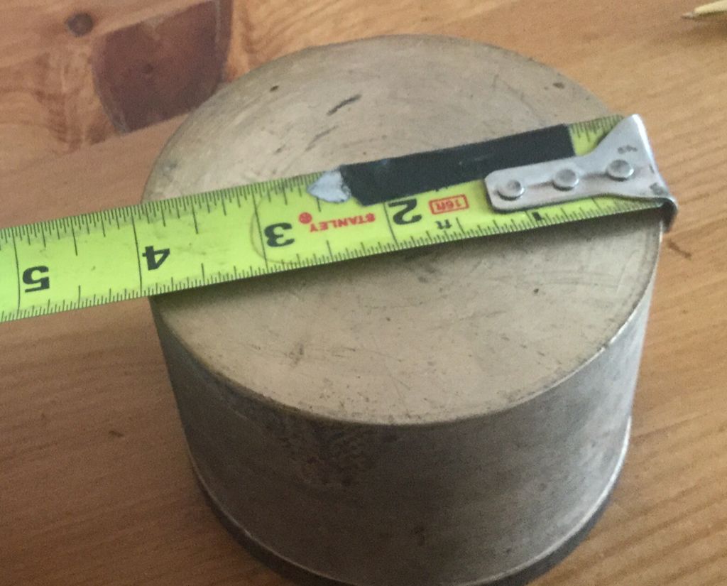

I know from personal experience bearing bronze can be spendy depending on the flavor & size. It can be purchased in plate form in smaller chunks which might suit your needs. With some bandsaw work you could pre-cut the extremities & some of the ID to harvest some usable chunks for another project.

I’ve got a piece that I assumed was bronze but it’s a lot yellower so is likely brass.
