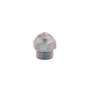

I needed a ball oiler for my rotary table, spent a bit of time and made my own, then came across this. Twenty for 5.45? we will see when they arrive from Japan
