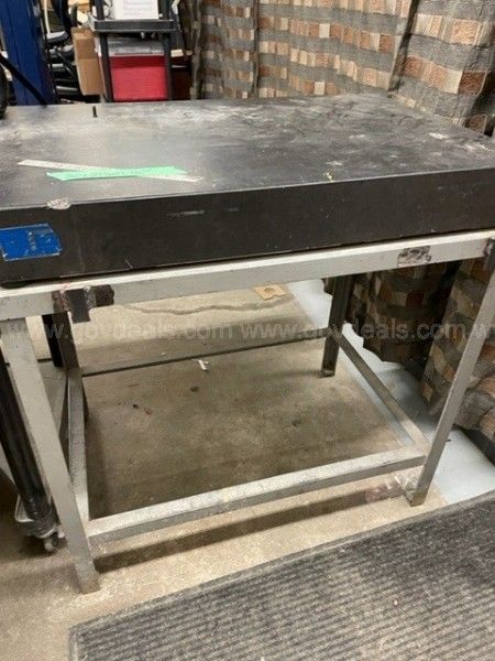

36X24 'surface plate' -- Peterborough, ON
trlvn
No idea how flat this is anymore but maybe somebody is interested?
Currently awaiting an opening bid ($10). Note the two dingleberries on the edges.
For up to $150 it is worth the risk, but only if you're local. Surface plates can be reconditioned...
I have one from a friend (retired at 80) who gave me an extremely good deal and I know its history and how little it was used. Looking at this one, be careful as it does have chipped edges and a few gouges on the surface. I'm with @Dabbler on the price (as the stand alone is worth it).
By the way a new plate that size starts at about $500.00. The stands at about $1000.00
