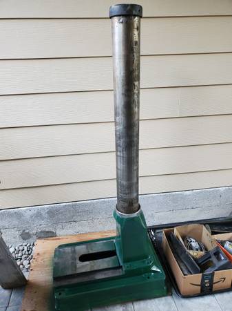

2 hp full height milling machine. - $500 (Squamish)
Really good price. FWIW, I filled the column of my now sold RCM with a combination of lead and grout and it made a noticeable improvement to noise and rigidity. The original motor pulley on mine was wonky and I replaced it with a PA taper lock pulley.
For $500 you almost can't go wrong as long as the moving parts are there, or mostly there.
People pay more then that for a crappy drill press at a box store.
Plus it's apart and looks repainted. Clean up the machined/moving surfaces when putting it back together and enjoy.
Picking it up tomorrow. I’m told it’s missing the quill clamp #52-53-54-55, and the fine feed worm gear assembly #23. Assuming it’s similar to the Grizzly G0705, shouldn‘t be too difficult to get up and running. This years fall project!
Includes a nice size indexable carbide face mill, and an Autolock milling cutter chuck.
