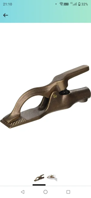

@Janger like these ? You're right those spring ones are garbage, 100% worth spending the money when that little sheet of copper or braided wire burns out
I have both of these styles, the first one is my favorite, when brand new it takes two hands to open the clamp, I just had to replace one...spring broke after 3 years, i have a pipedream of melting it down for something one day
The screw ones are good when you don't want to have any stray arcs from the ground
US Forge Welding Heavy Duty Bronze Ground Clamp 300 Amps https://a.co/d/6T5f8Fz
Welding Clamp G Ground Earth Clamp, 500A Brass Material Classical G Shape Ground Clamp, Ground Welding Earth Clamp for Welding Machine, Oil Exploitation, Automobile Manufacturing https://a.co/d/0MOpcNT

I put one of those first ones on my Primeweld and it is definitely a two-handed affair. Light gauge metal beware!

Exactly my earlier point. Love my cables. Hate the connector clamp.
