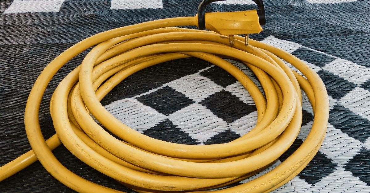

You can get brand new cable from Amazon (40 amps):
Or for $5 more you can get this one from Vevor (free shipping, 30 amps, same length)
Tom Kitta
FYI new cables are 149.95 from amazon.ca
Note these are 8ga cables but a lower temp rating for RV which rates it for 40amps 50amps can be done just watch for the cable getting warm for a short period. I did the research when I bought the Primeweld as it listed 50amps. They said unless you are running full power 100% ha ha ha that the only time you'll really need to be concerned.
TIG 200 amp welder max current is under 30 amps - and it has 60% duty cycle. One could consider extensive length of connection - say multiple extensions connected together - heat at connections & voltage drop due to distance.
Similar for TIG 250 and similar welders.
I.e. for most pp 8 awg is fine. I.e. 30 amp cable.

thats ok for 120$ for sure, I have a few of them, they are ok in the garage (and that's where mine stay) where you dont have to lug them around, but they are seriously over kill unless you are powering 350-400a machine, although nothing wrong with overkill
coming from experience 10awg is the more common size for a welding extension cord for a 200-250a machine going hundreds of feet, even the 300a+ shop machines are usually fed with 10awg (although usually only 20 or so feet), yes i am referring to single phase
