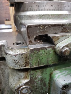

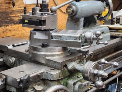

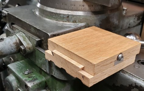

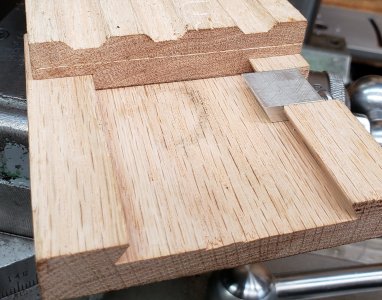

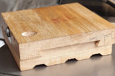

I have a carriage lock, which helps when parting or facing. But no cross slide lock. I'm thinking it will be handy when drilling or reaming using the toolpost, interrupted cuts, or when using the toolpost grinder. My lathe has a full length gib on the left. I read some posts about drilling a hole and using a ball bearing backed up by a set screw. I don't like the thought of damaging the dovetail. So, here's what I'm experimenting with. Of course wooden mock-up. It takes very little force to lock up it up solid. I tried to measure it, but the minimum my torque wrench goes is 10 in.lbs. , and its way less than this.

VicHobbyGuy
That looks like a lot bigger mod to the cross slide than just adding an extra 'locking screw' (or two) to squeeze the gib. Perhaps I don't understand what I'm looking at?
RobinHood
I would put whatever locking device you end up going with on the gib side. This forces the movable part of the cross slide hard against the straight side of the dovetail. More repeatable that way.
If you put the lock on the non-gib side, you might get “rocking” of the cross slide if you don’t have perfect gib mating surfaces.

The atlas mill I just sold had the style of gibs that were adjusted with four screws each, each having a locking nut. Except that one of each set of four had either a knob or a handle for tightening it down to lock that axis. It worked fine. If you have the style of gib that adjusts by means of a single screw at the end, and is tapered, you'd need a different approach.

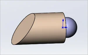

I like the design aspect that your shoe has the matching angle to the dovetail (agree with @RobinHood) gib side. But a potential concern that you have a relatively big notch removed to accommodate. Hopefully the material wont stress relieve there. My (Taiwan 14x40) slides have a threaded hole drilled through which intersects the gib strip. Its very primitive. The screw bites away at the gib strip with pecker marks & you can see movement on the DRO while tightening. So I made this shoe out of brass & Loctite a bearing ball in the end. The bolt was center drilled so it just pushes axially on the ball with no other movement. You could put a pair of them in the side & double your clamping pressure.

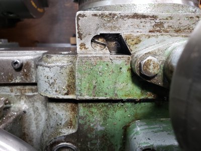

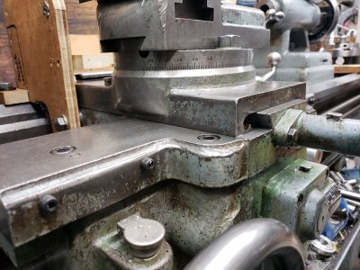

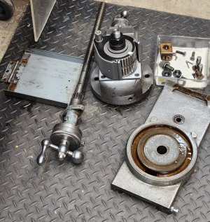

On my cross-slide, there are no adjusting screws on the side which push on the gib. Instead a have a long steel tapered gib which is adjusted by a screw from the front (closest to the operator).

Interesting. I would not be fond of reaching on the chuck side to engage the lock. Better on the tailstock side. Still. I wonder if the threaded hole with a floating shoe idea could work?
thestelster
Hi Peter, having the lock on the head side was a safety concern of mine as well. In terms of a shoe in a hole like you described, might not give me enough bite on the dovetail without using excess force. My cross slide is 13.5" long, so notching it out 1" or so for the lock shouldn't reduce the overall strength or integrity of the unit.

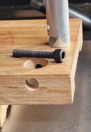

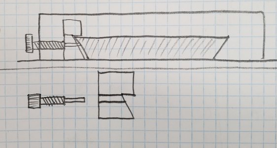

So does that SHCS have a reduce front section that passes through the clearance hole in the pad, so that the shoulder pushes on the pad? But you mentioned its a standard SHCS.
See photo below

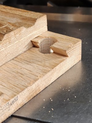

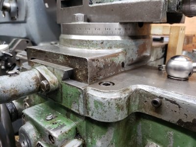

Well, today, I decided to get to this cross-slide lock project.
The main reason I want to do this is because I use the carriage to do most of my drilling and reaming, and there is the slightest shift from zero in the x-axis when I start to cut. No more than 0.001", but it bugs the #$%& outta me.
Also I'm sure it will help during interrupted cuts.
I will be installing a lock ala Cholchester that @RobinHood has showed me on earlier posts, and it will go on the left side so that it pushes on the gib.
Stay tuned!! I hope I don't firetruck this up.

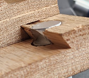

So, of course I always make a mock up from wood to test my design or, in this case Cholchesters', and see how to incorporate it into my machines.
And this worked out well, and pretty simple. Now to do it for real.

I assume that all that is upside down.
You gunna put a handle nut up top?
