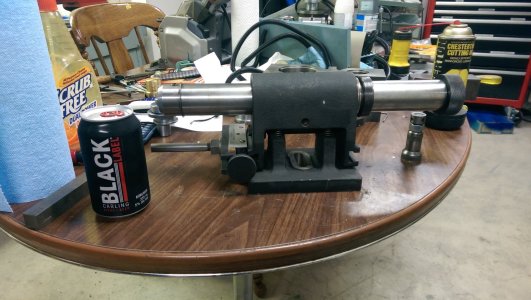

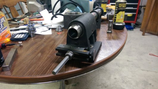

what do you need? imo, an air bearing and a diamond cup wheel. Getting the helix right is done by the tooth rest following the recess in the front of the cutting edge. Its a challenge imo to do so without the sensitivity an air bearing gives. If you do as I do and not worry about the ends, and you batch things, doing a large lot of them, it goes fairly quickly. Do wear a proper respirator (not just a paper filter) if doing any volume of carbide as grinding it releases cobalt dust which is not on the list of daily recommended vitamins and minerals
to save some typing, some rational cut and paste from the accusize grinder thread
- unless you are plunging, you're not cutting on the end. Indeed the end is relieved a degree or two toward the centre so it doesn't rub. Unless you are plunging, the wear maybe all toward the end, but its still on side of the endmill.
- I stopped bothering grinding the end. Its a PITA (even without worrying about the gash) and 95% or more of what I do is not plunging so when an end mill is worn, its the helical side that needs grinding not the end. grind the sides a go back to work :)
- yes you can sharpen the sides various ways, but it's a royal PITA without an air bearing...and is soooo easy with one.....one of the reasons the usefulness of these is a lot less imo than you might think if haven't ground end mills before.
Tom O
I have both a Deckel SO tool grinder and a Clarkson T&C Grinder with all attachments except the air bearing. So far, I have not fully ground end mills (my box of “to be ground” is filling up more and more though). I have used both (and the surface grinder) to make specialty tools for the lathe & mill. They work very well for compound, precision angles.
I foresee, when I run out of end mills, that I will setup a “grinding session” and just do all of the dull cutters at once…
I will probably do a little write up on how it went and lessons learned.
I’m in the Doverglen area if you wan to borrow this a collet would have to be made though.
I guess I'll have to add an air bearing on my Deckel clone...., thats an easy one to do.

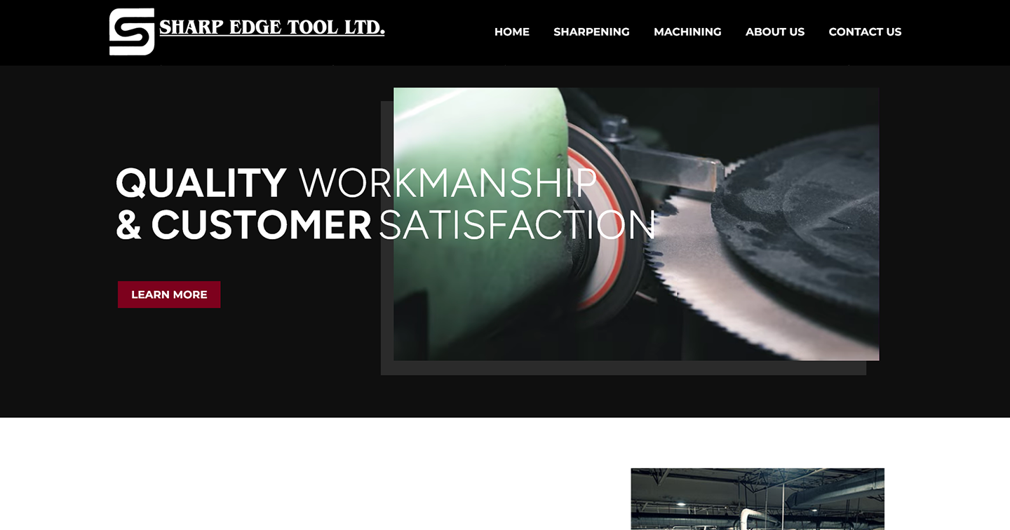

I can't really see myself sharpening end mills myself. Heck, I can't even sharpen a drill bit decently. Sure, they work, but nothing beats a 15 minute trip to Varco for a brand new high quality drill bit. Saving up all my end mills and drill bits for an occasional trip to a sharpening outfit makes a lot of sense to me.
This place in Windsor does endmills. Drills, I do myself.. maybe show me on my field trip....
