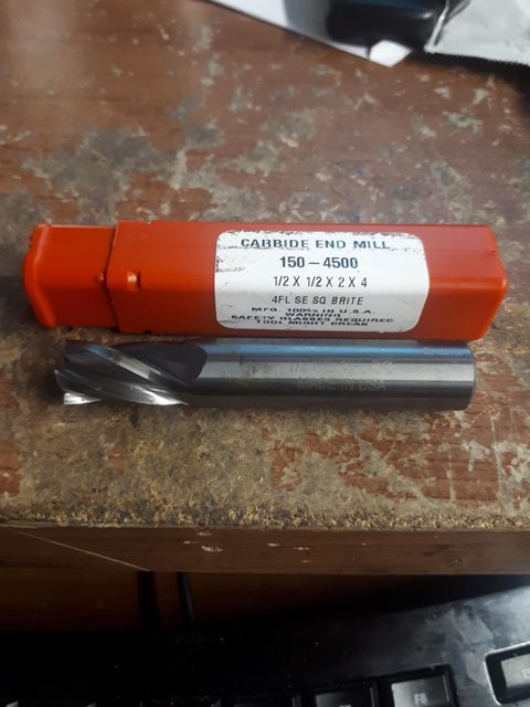

For context I just dug through some emails for some #'s. A brand new 1/2" 4flute Niagra bright finish std carbide endmill is $27 (todays purchase), and to have that same endmill sharpened (dia/ends depending on requirements) is $14 (price from last order in late 2021).

They are not branded "Niagara" They are generic "made in USA", but I've heard from a few different people (tool vendors) they are in fact made by Niagara. The truth? I'm not 100% sure, and I probably shouldn't have said Niagara without knowing for sure TBH. I use them for general purpose milling of O1, and other tool steels, and they perform the same for my needs as the more expensive "branded" ones (except for a few) I've tried over the years, so I've never bothered to look elsewhere. For aluminum I use actual Niagara branded 3 flute high helix endmills, and they are amazing. More $$, but they are worth every penny for aluminum.
KBC price IMO is generally more expensive than what you can get from some industrial suppliers for generic things like endmills/drills if you have a decent volume. We have a guy that we've dealt with for a very long time for stuff like this as well as quite a lot of the other products/hardware we use. I'll ask him if he doesn't mind his name getting out there before posting it up. I know some of our other tool vendors don't like small/hobbiest accounts. We're not a big high volume customer, a small shop really, but it does pay to shop around and develop some relationships with vendors of frequently used tooling.
This is one of those endmills, that has been reground by RME on both dia, and length a few times now.
After typing this post, and looking at actual branded Niagara endmills I DO have in stock, I'm not so sure anymore. I know there are a ton of variables/models/lines etc, but there are far more differences....For all I know now, these could be rebaged chinese endmills, and he's been pulling the wool over us for years lol. Either way, I've always been happy with them.
