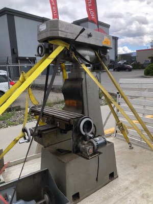

Shop rat
New Member
Might have something of interest.
