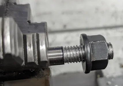

Ok, the whole "calibration jig" is a touch Rube Goldberg, but it's working, and I trust my speed output.
bfagLmIzOKULKzyEGdZy2vyYWlXBTdit0-Q2pNUbtRv9x0DQQSPfsWz4w2ZIaF2T8Q8PPKvkcQfyncsERkAMt6hGEZlC7AxXKMAW23Pssu-esLWMeME-HXI7z8UGyJxe8-m4AJMWvzVSm7xT_1TwFlKllyZ6XySY8K2jjTYntZ37jMvD6jd7PgOsoGVk03S9immZQi8S6szPOKCe4V9O4lG89H3Y6E2BZU5FR20uOI8cys1T-1rx6LJOhjYc5QMKlqn9XLgy_NpPZlfhrc5DQmv-ODmKFbE2wZ7pjIT_vFgqmvk4Ml0Gfo9K8ylAvWMFlcdB2W0PUkrtGWuvgGE83FM9DfVriGi_d5nSIIZqtvWPAJE5WCPpEAWP7Sr7AnGPgGjCUtMECEaAjPNaiEFiiD4E5LCo6a_KwesKmJfZ0ujILwd5Kl8qbwPAdlPS7nfDecSP_DhMrwuLWq6hivSDpCze32G--YlwQS1ZRQCBV7TAK6-gTjPfMUIr93h--D__ElrMr6RM8HXzyj2HfvkevOcObIXwPS65X4D0x0fr8bTVLdFHo812OSJwEGG05KUdtTVA5iDXFeqTL73Jtjl_T0NnYw13jiVdaBxlN1daDaOX_oRmHPPbAAUnIP3pNBYqCCrvw-MEE4nRMv6L7mS4pSS8hwrvtLAiVVpRwLkUq3eorSFwMBLzW95pA5YQCWbLYez2mAOHpTvJ8axds62NYrfR5KAqwln30x6HG9NfdcK3Q7WVeTTMhsEtPCETECS52K6oKoYyxaZJPopUYkGL-nYJWdIFm0d21HM4uPcSuR7129qGVWVim8QqWVxwOf_xi6K9RJtF0AH3uQpQmZHB8QKu5Xx7wL3ur9f0h2XtnL6b9Va8a99daoxnoe0oyZWeiHI0vDyrQ0CfdVcYWiRe9Qm2RiGwoL02GLMdYMCbv2knUg=w2582-h1943-no
I have an Allen key chucked, with the optical interruption sensor held in a quick-change tool holder, which made alignment really easy. That snare of (too short and messy) wires go to the breadboard where there's a couple of resistors thanks to which I fried neither the sensor nor my logic analyzer. It also has a bypass cap to reduce noise on the sensor. The logic analyzer hooks to the breadboard, as well as power and ground coming from my controler, in case I wanted to get my encoder pulses at the same time as the index pulse.
Logic analyzer snapshots show the thing repeatable and the displayed time is correct as far as the logic probe is concerned.
Thanks @jcdammeyer and @Susquatch for the support.
Biggest hurdle to overcome to make this work? The brown and black wires on the sensor are reversed from the random diagram I pulled off the internet - black wanted +, brown to ground.
On to making some test threads!
