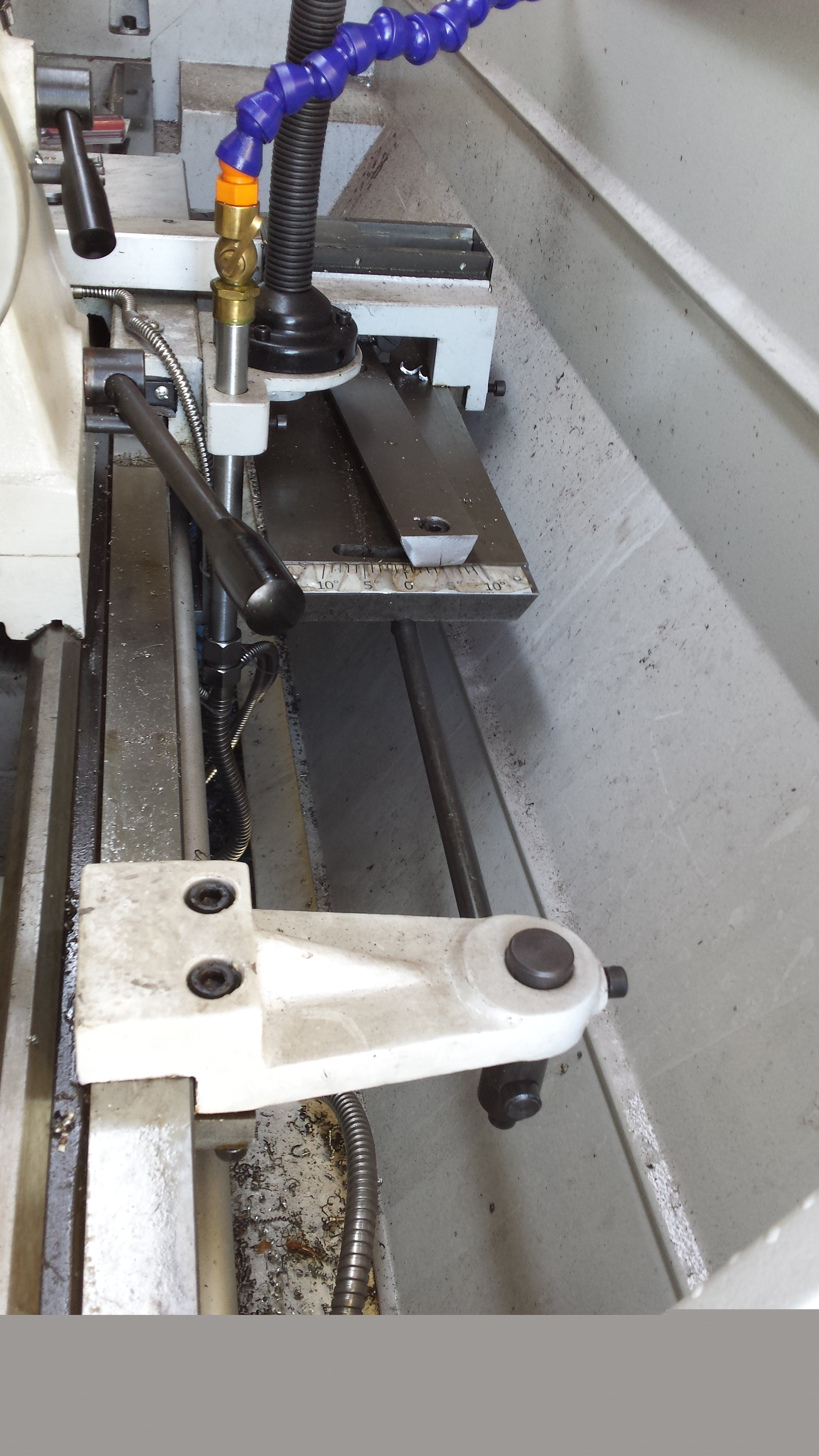

Yes the lathe is from modern tool and it had the taper attachment on it when I bight the lathe. Hopefully I can answer your questions so I don't have to take take a bolt or anything out of my cross feed the y axis to use the taper attachment. I don't have any drawing for the taper attachment it's self or a pdf it never came with any but I know you have to take the block off the back of the cross slide to put the taper attachment on and the lead screw does go inside another block I went out and took some photos of it for you. I haven't used it at all really just once to try it but my buddy bought the same mill and has set up his to re cut a mores taper and it worked good for him.

Thanks for taking the time to snap those pics, Ed. Very helpful. Hmm.. now that I see how things bolt up, very similar to my lathe. I'll have to check if I have those matching threaded holes. This is the part I've been wondering about - how the slider block attaches to the end of the lead screw. So dumb question, I can understand how the lead screw goes in the other block (taper attachment) but how do you 'disengage' lead screw from the main cross slide nut so the cross slide is able to float guided by taper slider assembly? ie. it looks like you have the same nut & bolt through the table as mine judging by the manual picture.
I think you have DRO on the Y-axis? Do you also have an X-axis scale? That's another potential issue I'll have to work around but looks like your taper brackets (holding the rod) just clamp on the bed way lip. Is that kind of how its installed?

@PeterT if I'm getting what you're asking right, this might help: the leadscrew won't really disengage, when you have your taper-attachment set up and you have the lathe feeding you can watch both hand-wheels move. The leadscrew is still driving the cross-slide back. When you want to disengage the taper attachment you just unbolt the attachment at the bottom of this photo with the two bolts and the taper-rod going into it so that it slides freely along the ways. Hope that helps.

Yes Eric is right I don't unbolt any bolt on the cross slide but when you tighten the taper attachment clamp it moves the cross slide because if you actually unbolt your lead screw from you cross slide you won't be able to change your depth of cut. Now yes if you set your compound you can changed depth of cut but that's a different topic. Also yes I have a z axis readout and it's just bolted lower than the taper attachment so if you have one you just may need to lower it to clear the taper attachment. I'll take the bolt off and grab a picture for you of the block and everything that goes onto the lead screw.
Oh, duh me. I forgot you still have to have the lead screw engaged in order to alter depth of cut. Obviously I never understood how these things worked to begin with. So what am I missing here - if the taper attachment is now set up & its now 'connected' to the back end of the lead screw, does it actually draw the lead screw in & out on its own because its now constrained by the slider block? (by draw in & out I mean unscrewing the lead screw on its own). Is that the purpose of this rear connector part? If so, it must be some sort of bearing assembly? The end of my lead screw has cap screw & washer, assume that is removed & that's what the taper attachment part hooks on to?
