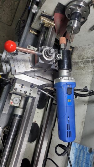

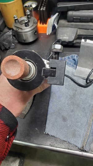

Here is what I used for a tp grinder. I wanted a more powerful and hopefully sturdier one than what I thought the little electric or air die grinders are so I bought a 700 watt variable speed electric die grinder from princess auto.
I'm not sure yet how successful the grinder will be as I have only done a bit with it and the 1/4" shank stones I've bought ate terrible.
It’s probably the bonding of the abrasive that is bad.
I would look for “mounted stones” online and go with a reputable name like a Norton, Radiac, Dumore, CGW, etc (not affiliated). You should also have a diamond dresser to true them up before use.
Yes the stones vary quite a bit on quality and some of them glued in so crooked they wouldn't be adequate in a hand drill. I did dress them all with a diamond dresser but the worse one practically were ground down to nothing and were so unbalanced until then. I did buy a couple of mounted stones from kbc and they were not so bad. The worse of the bunch I had were called 1/4" shank but were actually 6mm shank and of course unusable in a 1/4" collet.
