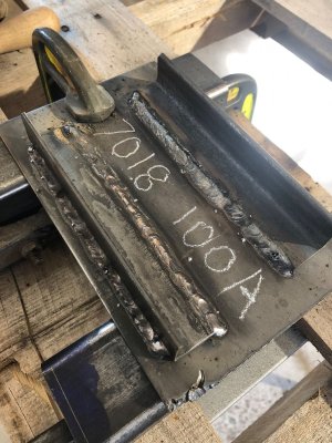

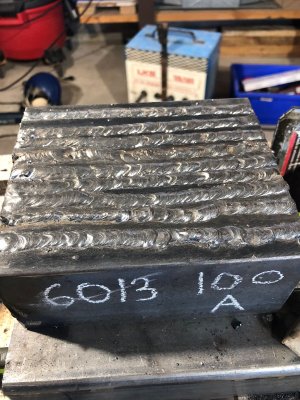

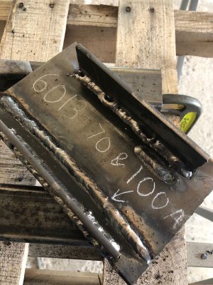

I did some experiments today with E6011, E6013 and E7018AC with my AC welder that has taps for 40, 50, 75 & 100A taps.
At 75A, AC- 3/32 E6011 has a lot of spatter, but seems to penetrate quite nicely.
At 75A, AC- 3/32 E6013 welds quite nicely.
At 100A, AC- 3/32 E6013 was welding fantastic.
At 100A, AC- 3/32 E7018 did beautiful welds, but I couldn’t keep the arc going and the longest bead was maybe 1.5”.
So today, with my AC welder, my favourite rod is E6013.
Here’s my experiments:
And now I’ve selected my “favourite” rod, I’m just running beads to practise:

were you trying 7018AC? it has arc stabilizer's that normal 7018 does not have, this allows you to burn 7018 on ac, 6013 already has the stabilizers as it is designed for AC or DC
you will also notice there is a distinct difference in the brands of rods, you should give a couple brands a go, you will probably find a brand of 6013 you like the best

Your 6013 flat welds are looking good and i would recommend wiggling side to side tiny bit it can help even out your bead width but biggest thing when you first learning is to adjust you helmet till you can see the puddle and arc the best so you can manage arc gap aswell as see when puddle stabilizes and becomes oval and glassy then just trying to keep it that way hole time. set up some test plates and fill them up, you will find you'll have to change your technique a bit for each set up to get the desired results then you'll have to start all over when you change positions flat to vertical is usually a game changer but 6013 does vertical fine more forgiving then 7018 anyways.
