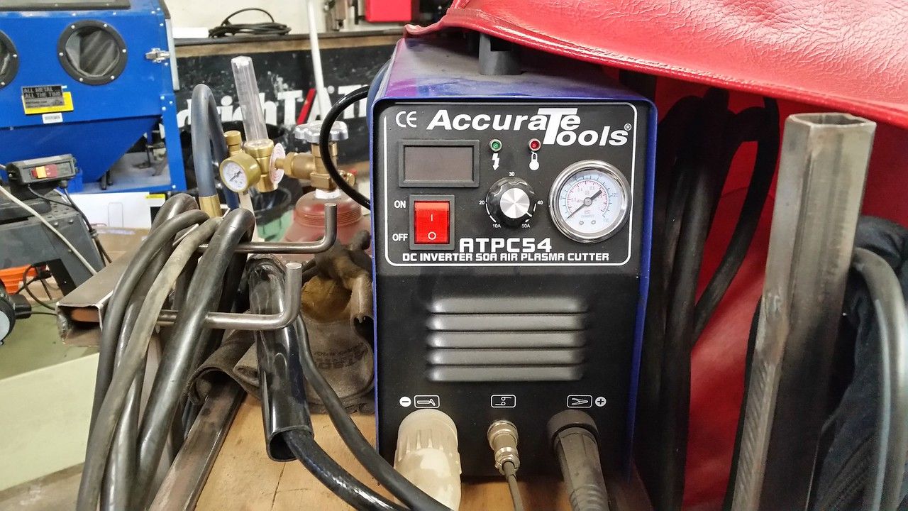

I have a cheap Chinese plasma cutter that has never performed well and has now quit working completely. I'm pretty sure the torch is at fault and I have ordered a replacement but I'm thinking of buying a better quality machine and scrapping this one. I'd appreciate hearing about other people's experience with their machine and opinions about what to buy.

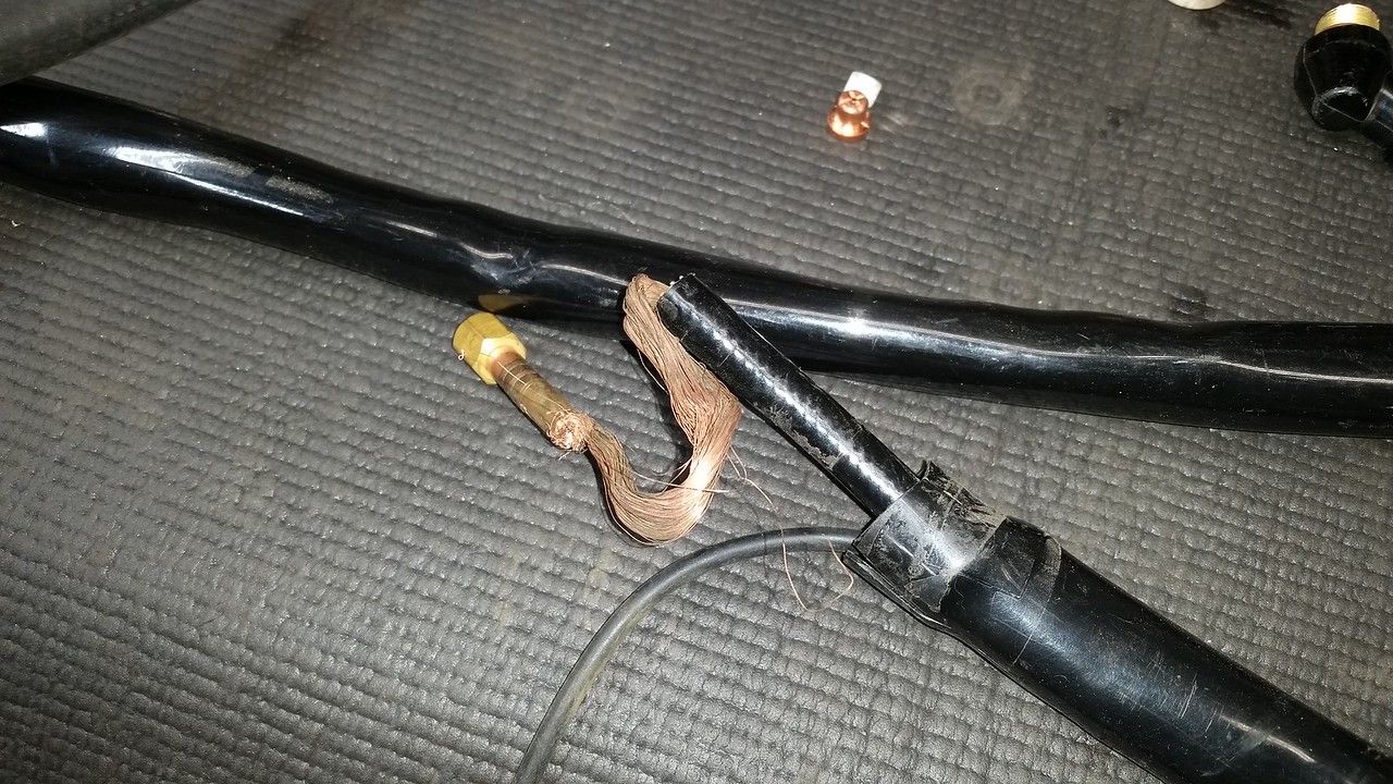

Thanks for the comments and tips everyone, I don't use my plasma cutter that often but that is probably because it is such a POS. It mainly gets used for cutting sheets of plate that are too big to fit in my band saw and I doubt I would ever have to cut something thicker than half inch. Since I have ordered a new torch I decided to disassemble the old one to try and figure out what's wrong with it. The main issue I was having is that the tips get burned up and melted very quickly even though I have the air pressure set up to 90 psi. (recommended pressure is 75 psi) I noticed that the volume of air out of the torch tip seems very low so I disconnected the torch at the machine and when I trigger it there is a much larger volume of air out of the machine when it doesn't have to go through the torch. I disassembled the torch head and cut the crimped clamps off both ends of the hose and when I pulled the head end out of the hose the problem became obvious. The multistranded cable that carries the current to the torch tip runs through the hose and to get it connected at both ends presents a challenge so whoever assembled it just folded about 2 inches of the cable over and stuffed it inside the hose. This was done at both ends and pretty much blocked off the air flow due to the volume of wire inside the hose. I have run out of patience with the torch but I may try to cobble up a hose extension to test the machine with more air flow to the torch head.

I made a temporary repair to the old torch using a short length of 3/8" braided hose split lengthwise and slid it over the uncovered portion of the conductor when it was stretched to it's full unfolded length. I just used electrical tape wrapped around the short piece of hose to seal the split and both ends. After re-assembling the torch I now had lots of air flow but still no arc. After watching this video
I decided to follow his suggestion and check the arc start contacts inside the machine and found they were almost touching. He says in the video to open the gap by bending them. I did that and opened the gap to about 1/8" from about .020" now I have an arc that looks like the one on his machine and it cuts properly. I'll do more performance testing once the new torch arrives. I didn't take any pictures so I used a couple of screen shots from his video to show the arc contacts.
