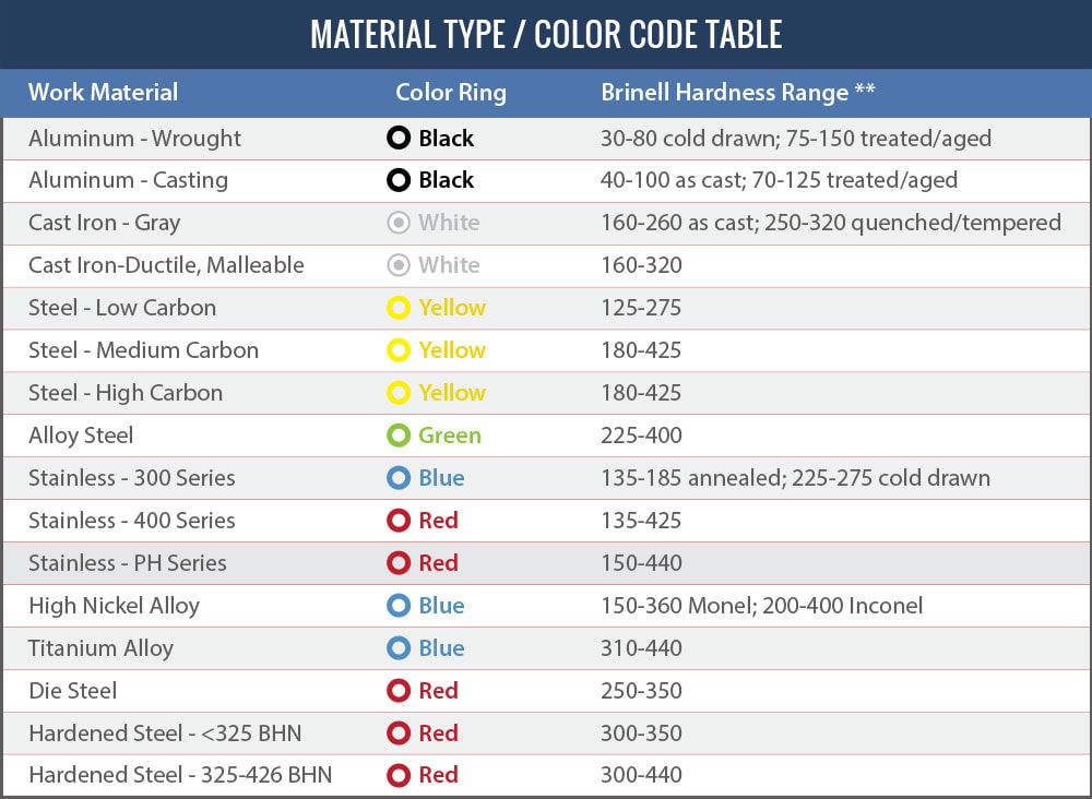

That's good to know Sowa is selling on Amazon. I use these same taps & they are awesome. These seem a bit spendy but could be the designation, mine are blue ring & these are yellow ring. I'd have to look up what the designation referred to. Shipping is very high even with Prime. SOWA is a distributer so any machine shop supplier should be able to source or stocks. Even so, didtributer prices vary.

Here's a tap colour code chart.

Yes, any decent, as in European, machining book will show: This is from Mechanical and Metal Trades Handbook, excellent and much better than Machinery's Handbook for real world use (but of course metric centric)
That's Awesome Gerrit! Thank you!
Love the euro shot! Why didn't I guess that was coming from someone! It also explains why I could not find a lot of such things. I need to crawl out from under my imperial rock a bit more often. Good 2024 goal.
Just Great - another book to lust after! Better than Machinery's Handbook eh.... That's a tall order and a very strong recommendation.
