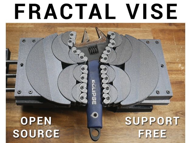

Oof. That is spendy! But it definitely ticks the boxes on the 'cool factor' front.
For those of us on a budget...

I was trying to find the post on that fractal vise but couldn't locate it. Searching on "vise" was a waste of time. and then I tried mandelbrot vise no luck there. Fractal! that's the word. That one is very cool but I can't imagine milling anything with it. Maybe if it was printed solid out of a high strength material - carbon fibre? Imagine how many spools you would need at $50 or $100 a spool. I think it would need to be made of steel realistically.
I've asked Thomas Skinner how much that norgren vise jaw is. We will see but I can't imagine it being affordable. So I'm imagining a sandwich pack of aluminium 0.25" thick 2" by 4" jaws. 24 on each side. bolted together. I'll post some musings...

... I can't imagine milling anything with it. Maybe if it was printed solid out of a high strength material - carbon fibre? Imagine how many spools you would need at $50 or $100 a spool. I think it would need to be made of steel realistically.
Funny, one of the comments on the thingiverse site mentioned filling in the plastic voids left by infill with epoxy to make the part stronger.
I'm not sure the 3d printed vise itself would be strong enough, but if one could use those parts as a starting off point, lop off the vise portion, and then have the fractal jaw mechanism somehow tie into a machine vise for support, maybe they'd be strong enough? Probably would depend on what material you're milling. I admit my knowledge of the forces involved and the strength of printed parts is not that deep.
