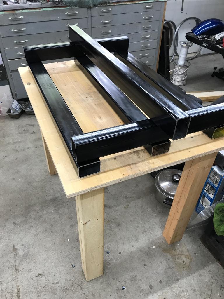

Built the table for the CNC router.
Nothing special, just construction lumber from my stockpile.
I’ve since added a shelf for the computer and electronics.

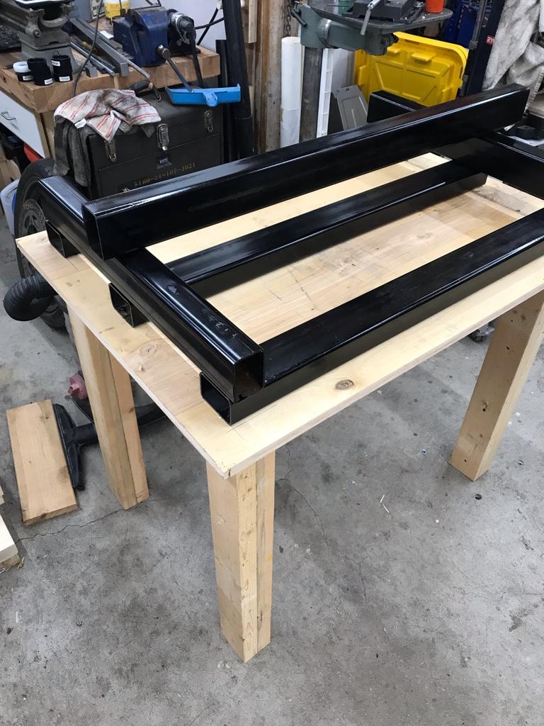

Drilled and tapped the major frame members.
Three X beams = 24 48 holes not tapped.
Two Y beams = 24 holes tapped for M6.
The grey things are 3D printed patterns for marking hole placement.

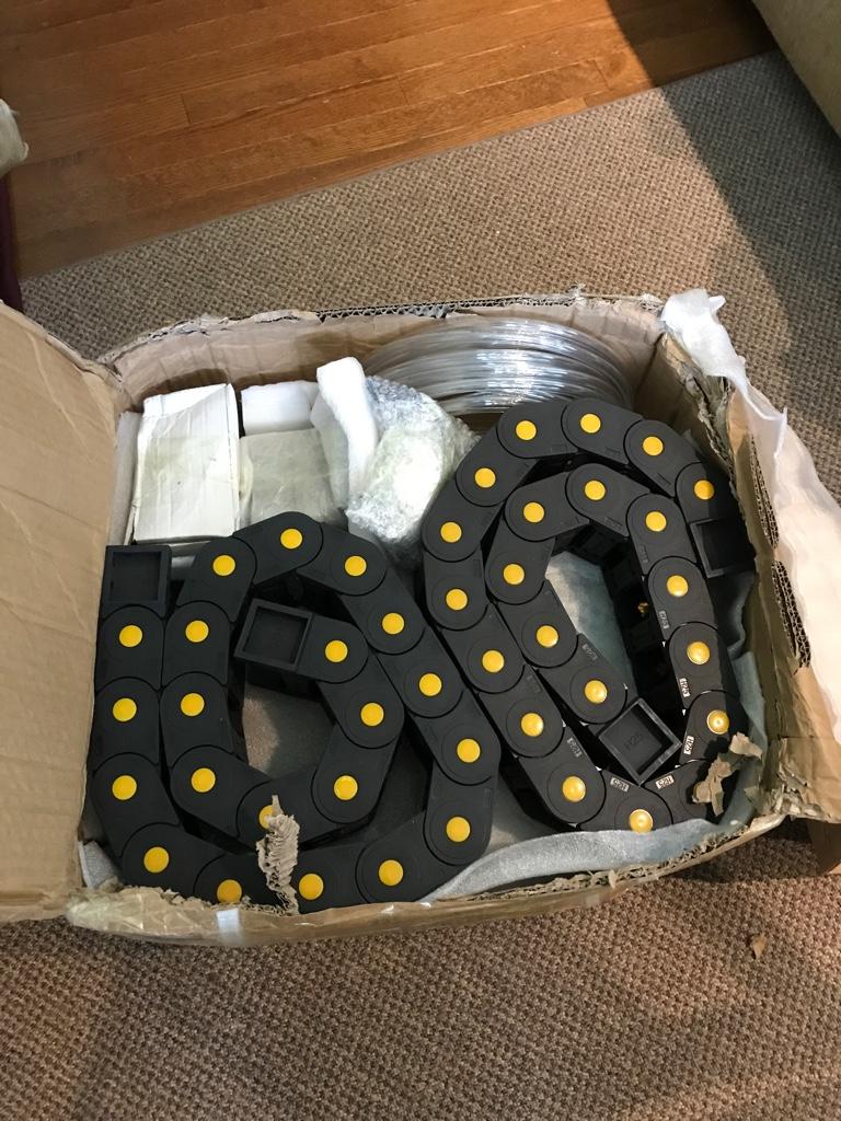

Rails, ball screws, steppers, drivers etc arrived today.
DavidR8
Scrap maker
I'm pretty impressed with the delivery. The boxes are very heavy but the boxes are intact.
