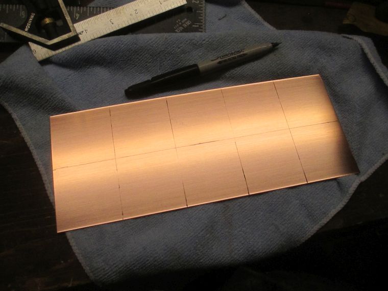

I started with one sheet of copper and one sheet of brass. Nice and clean.
This was overpriced at the hobby store, but I figured it was saving me the the scrubbing.
These sheets are 4 x 10" which should make five 2"x2" pieces per per sheet.
The copper is a little thicker than the brass, but we'll live with it.
With a ruler or square and a permanent marker, layout the 2" squares.
Do this for both the brass and copper sheets.

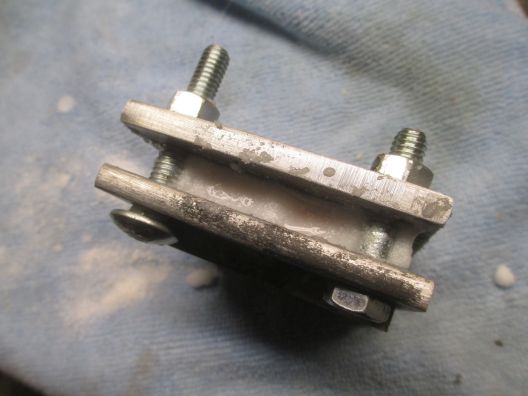

I squeeze them into my handy compression plate thingy.
It's really two pieces of 1/4" plate with four 5/16" bolts to squish the copper and brass.
Clamps also work, but whatever you use has to fit into the forge for heating.
As per Tim's suggestion, I got some Borax. No, not that crazy comedian from Sloblazekhstan, but rather a trip to the Walmart in the laundry isle.
I mixed a small amount of Borax (3 teaspoons) with a smaller amount of water to make a paste.
With the brush I applied the paste Borax to the perimeter of the stack. All the way around. Covering everything in the cracks.
On one of the longer bolts I fitted some scrap steel and a nut for a handle and tossed her in the forge.
Once in the forge, watch. Turn like a hot dog. Even heat through the billet is the aim.
Now the whole thing is glowing yellow, pull the billet before the brass melts and leaks all over.

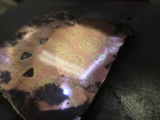

Over to the drill press to pop a bunch of semi-random, PARTIAL holes. I am using a 5/16" bit for this.
Now that's a bunch of sort of random dents. Some are deeper, some are shallower.
Now back into the forge until you see it shimmering in the holes.
That's when the billet is dull red.
Over to the post anvil for some flattening with a 3lb hammer.
I did the heat and flatten 3 times. Trying to squash and move the layers up the holes.\
Holes down seems to produce the flattest, best results.
I started some finishing on the 4x36".
After a little grinding I can see the circular patterns appear.
I finished the rest on the 2"x72" with a coarse 60 grit belt.
Then I hand sanded with some water and 150 grit.
Then 220 and 400 grit with a block.
To the buffer for some black compound.
The product turned out pretty good. I will need additional shaping and polishing in situ.
The net result is about 3/16" thick by 2-1/4" x 2-1/4".
