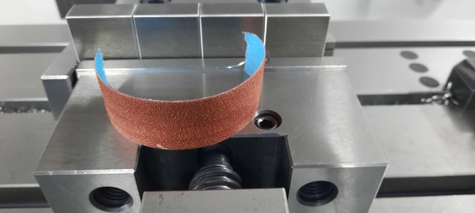

I have some 3d to run over these 4 blocks. I've got about 1/4" in the vice.
This material is just 1018 for soft tooling try outs.
I use emery paper alot when doing this type of machining with multiple blocks.
Toe clamping on a fixture plate just wouldn't work in this case.

Sure,
Material is C1018 that doesn't need to see the surface grinder. If I try to machine the 3d profile over the top in a smile type shape, going down to about .02 off vice jaws through the middle 2 blocks, the blocks will have a tendency to move.
These blocks will be installed in assembly afterwards. If I did these 1 at a time.... I would have some clean up and blending to do within the shape on assembly.
Without the emery paper , I know, at least 1 could pull away and shoot out the vise. Then it could/would be a domino effect after that. I've done that before lol..
Saw another guy doing this at another shop several years back and thought dam, that's pretty slick, so I stuck with it.
Since doing this, I haven't taken the side window out of this mill yet lol.
I never considered super glue. That sounds pretty slick as well.
