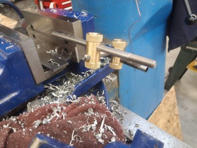

Here is my milling vise mounted work stop.
Overall pretty happy, but the brass seems to be quite slippery on the rod. The rod fitted to the vise is an M8 internal hex fastener with the head turned down. The rest of the rods are left overs from a shift rod kit for buddy's old car... his mistake = my free material!
Brad.
Yup - set screw would have been easy, but the idea is that the knurled brass bit pulls a threaded piece up, locking the rods. Will get pics of pieces...
Each main body holds two threaded pieces, and the knurled bit is a nut.
That sounds way better then a set screw for sure.
Do send over piece pics! Any specific reason for the brass as opposed to steel or aluminum?

@JW: no specific reason except that I like brass, and had some 3/4" stock left from making brass fingers for my fixed steady...
@ Peter T: Mine is threaded directly into the vise. It is the dents I didn't want... so decided to try to build it like a dial indicator stand connection. I looked at doing a slit and screw clamp too, but was thinking of something that wouldn't need tools to set up.
Of course the handles on the table mounted unit don't need tools either.
I was reading about the self lubricating properties of brass the other day, makes sense!
How did you mount the stop to your vise? Just drill and tap a hole?
Yes, I drilled and tapped each side, so it can be located on either side as required.
I am thinking that maybe drilling through the clamping bits I could get less surface area and therefore greater holding power (higher pressure) on the clamps... will have to think about that. They are a bit fussy to make - if I mess them up.

You offered some pics of the clamping mechanism - any chance you still have those a year later?
(even a sketch or link would be helpful.)
How is the slippery brass a year into the clamps?
