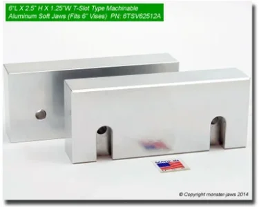

I also have a D40. I get my softjaws from https://monsterjaws.com/. Shipping to Canada is dear but I have them delivered to a friend in the US and he brings a box or two of 10 sets at each visit.
KBC has hardened steel jaws for $77 EACH. See 1-5724-003
Monster Jaws has machinable steel jaws but I've never tried them. Maybe make your own?
My D40 is often setup with aluminum jaws and Talon Grips.
I frequently need to change jaws and that is a pain with a hex key. I use a tiny 1/4-drive impact wrench from Princess Auto that together with https://www.amazon.ca/gp/product/B0186N7B8Q/ makes jaw changes quick and easy.
They say 1018, they look reasonably finished so guessing maybe surface ground but obviously not hardened. I mean surface ground would be nice, but if you're going to machine them & they are soft, one could buy a lot of jaw metal for that LOL. Even 4140 or stress relieved alloys would be a step up.

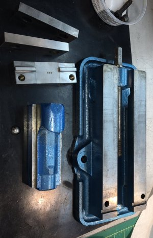

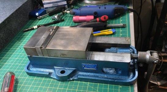

Well my eBay D40 arrived today. The jaws are pretty messed up, but they can be changed. I took it apart, cleaned it, did some measuring while it was apart and then some rattle can blue. About 0.001 out near the handle end (last inch or so), all the rest is really flat and equal side to side.
Added bonus, it came with keys, they are a little bit too wide so I will need to mill them just a touch.
