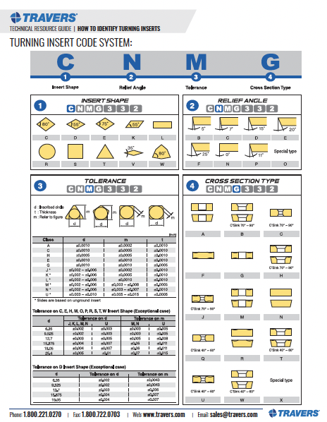

A useful chart courtesy of @trlvn
Travers has a nice 2-page pdf 'cheat sheet' for carbide turning inserts:
solutions.travers.com
Turning Insert Designation System Code Chart
Use this turning insert designation system guide to learn the name of the turning insert you need, or learn your inserts' specifications based on its name.
They ask for your name and email address to get access to the download but you can opt out of the emails at any time.
trlvn
