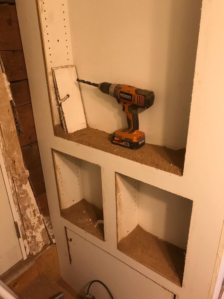

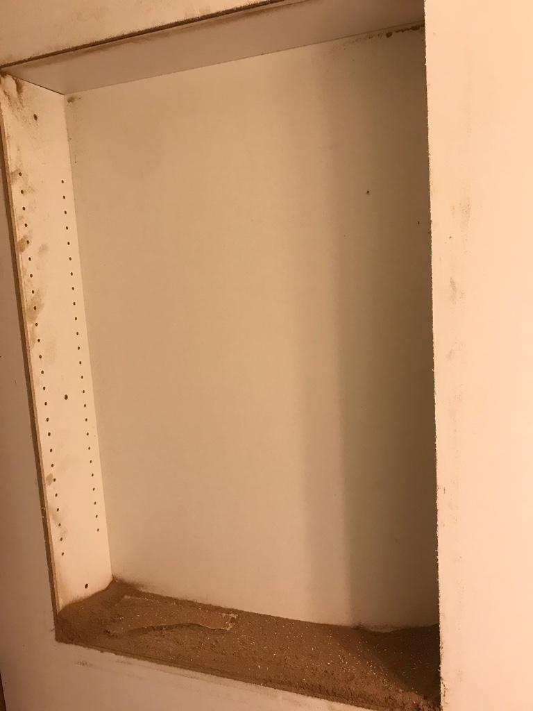

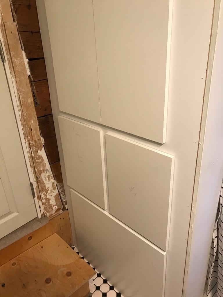

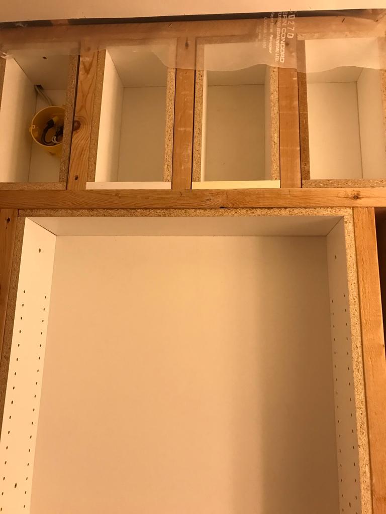

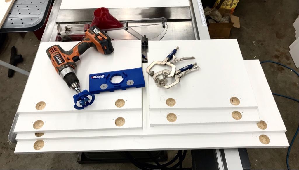

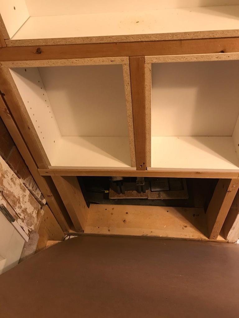

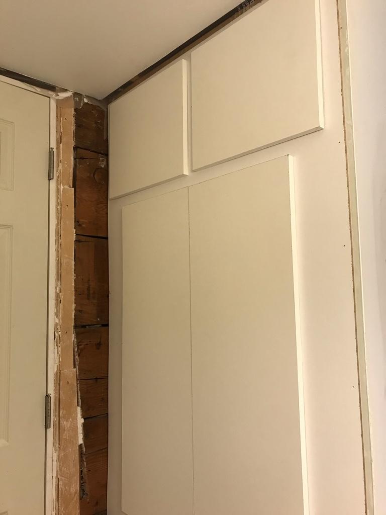

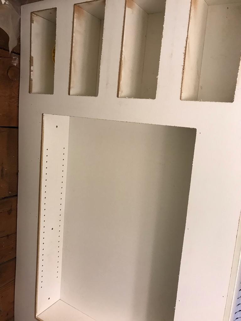

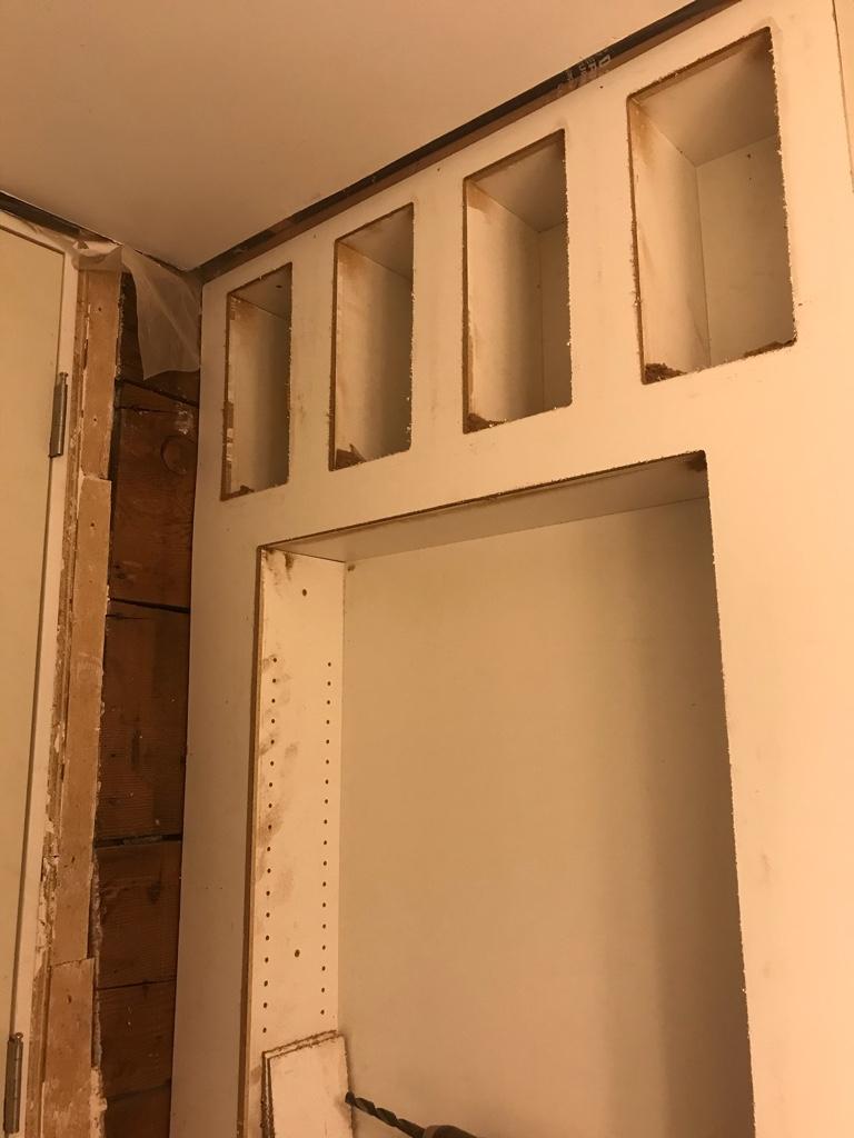

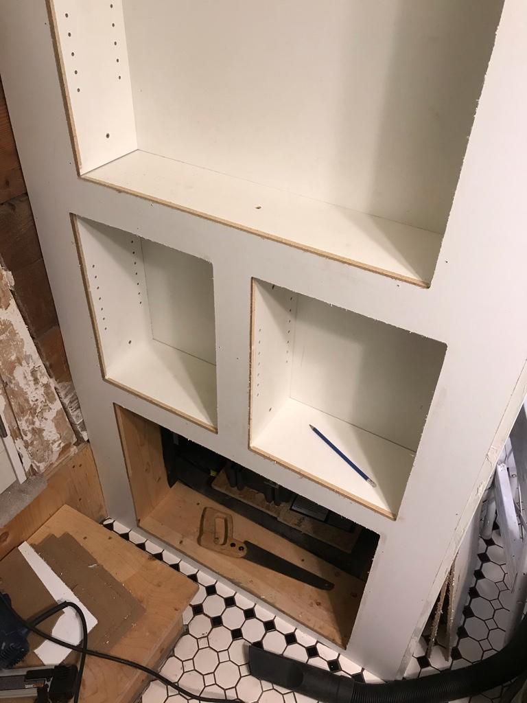

I’ve been working on an ensuite bath.
Built in cabinetry is near the end of the job.
Framing in and finishing work left undone by a previous owner.

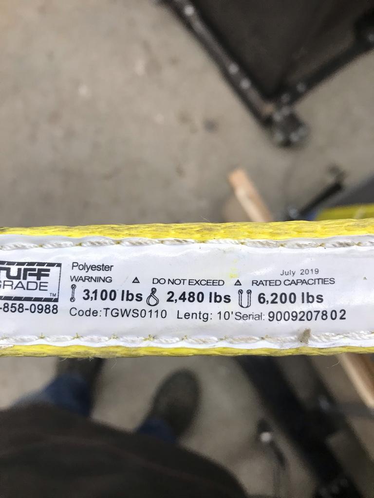

@Dusty
I looked at my straps and they have a much greater capacity than I previously said.
Straight pull - 3100 lbs
Loop - 2400 lbs
Cradle - 6200 lbs
And they are 10 ft.
Blame it on my lousy memory.

Thanks David good info to know before making a purchase., shall watch the sales as they turn up.
