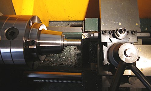

I picked up a couple insert type threading bars a left and a right. They are decent quality for the price.
Rather than thread toward a shoulder I usually thread with the lathe in reverse and the tool bit upside down.
With the treading bar I was able to cut threads with the cutter on the back side of the stock right side up.
I like to watch the chips coming off as the threads cut.
This was practice cutting 5/8" 18 threads on a piece of mystery metal. I fed the bit in straight next time I will
try cutting with the compound set to 29 degrees.

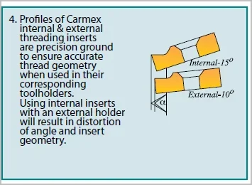

I might be wrong but I don't think you can use an internal threading insert on an external surface. At least AFAIK the the larger suppliers like Carmex list INT/EXT as different PN's.
You can invert an external insert & run in reverse assuming your toolholder/post can accommodate the new center height.
I'm kinda new to threading with inserts, but just offhand, I would think it's the other way around. You cant use external inserts to cut internal threads. But even that probably has exceptions.
I think the RH / LH also messes with the concepts.
We could exhaustively evaluate every case and publish a chart.

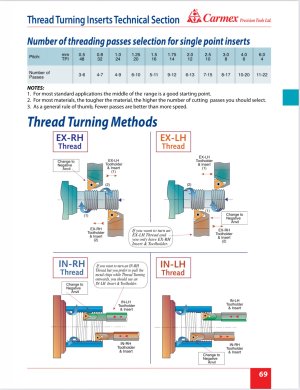

Good document. This says don't use internal inserts in external holder. That we probably all agree on. But is it a similar angle distortion problem if doing as OP is showing - internal assembly (correct internal holder + correct internal insert) but for external threading? I suspect so, but they don't specifically say. Probably because they always want you to use the right assembly in the right threading mode. Their diagrams are great for showing permutations of insert direction & resultant L/R hand threads, but notice they never show internal holder cutting external threads or vise-versa.
thestelster
Lay down inserts, AFAIK, are straight sided. They do not have clearance angles. Therefore it is the tool holder's insert pocket (for those tools without a shim) that is slightly inclined by 1° to provide clearance. (With tools that have shims below the insert, those shims are inclined by 1°.)
You can get right-hand shims or left-hand shims and of different inclination angles to match the helix angle of your thread. (The coarser the thread the greater the helix angle, therefore possibly requiring a shim with a greater angle of inclination, depending on the diameter of the thread.)
Right hand tools are used with right hand inserts to cut right-hand threads; and left hand tools are used with left hand inserts to cut left hand threads. But, if for example, you want to cut a right hand thread with a left hand tool (so you can cut going away from the chuck), you need to use a shim which has a negative inclination, otherwise the insert will not have clearance and will rub the sides of the thread causing a bad finish, excess heat, and possible insert or thread damage.
External inserts and internal inserts are slightly different in the thread form, specifically the root and crest. So using an internal insert to cut an external thread, and vice versa, though it might work, it will not give you the proper thread form.
As I readily confess, I am brand spanking new at using inserts to thread. I've been a HSS guy most of my life. I feel like I can provide good HSS threading and general threading advice but only interesting or thought provoking observations and questions for threading with inserts.
Your 1 degree caught me off guard. I would have thought it would be an order of magnitude greater or even more depending on the bore size. Say 10 for bigger bores and 15 for smaller ones. Is one degree really enough?
Lastly, please allow me to observe that all the reference info posted here on this one thread makes this thread well worth bookmarking for future reference.
thestelster
The 1° shim is what comes standard with Sandvik threading tool holders. If you look at that last chart I posted, you can see that the 1° is enough to accomodate many diameters and screw pitches (the blue area).
And yes, for HSS, the books generally suggest 8-10° clearance for turning tools. I don't know.
But, take one of your threading tools with lay down inserts, and look at it from the front. Can you see the inclination? Barely. But a 10°angle on your turning tool, you can easily see.
