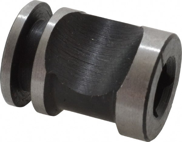

I can only think of four sources for D1-3 spindle cams available to those people in Canada.
MSC, and Penn Tools sell new replacements, for $58 and $90.80 USD each respectively. x3 Ouch.
I perhaps could find Taiwanese lathe manufacturer that manufactures a lathe that still uses a D1-3 spindle and try to buy directly from them. Lots of work involved in this.
I could potentially make one of acceptable quality to work in my lathe.
Or I can find someone parting out a lathe with a d1-3 camlock spindle and buy that to use the parts from it
So what lathes came with a d1-3 spindle?
TorontoBuilder
To clarify, I'm in need of spindle CAMS like this
To replace the ones the previous owner of my lathe bashed in.... so I had to weld a bolt into the cam to get it out. you can see they're all fractured and worn beyond use

you guys are talking pins...but I think he needs the cams :(
Some SM's and the 10ee are D1-3. Getting a lathe for less 58US x3 and the trouble/cost of moving it seems doubtful though. I'd be a toss up between make or buy. You'll be the better 300 after exchange, hst, shipping and carrier door step extortion fee. They aren't complicated but its a few operations and I aleady have 800 years of work...so a toss up.

I just want to get the parts asap... I figured the off chance one of the dudes south of the tri-cities has a lathe getting parted out I could just get a spindle out of.. I dont just need the cams, I need the can retention screw assemblies as well...
I sent a missive to colchester parts and another UK outfit and am awaiting their replies. I am happy I was able to knock out a few tasks on my long list bringing me closer to getting the chipmaster restored,

Colchester spares got back to me... they have all the original parts available. But the price, sweet baby jesus, I wont be able to eat for a year
1029 - Spindle Cam x 3, use D902H044.1, £41.00 each, ex stock
1161 - Plunger x 3, £22.40 each, ex stock
1225 - Spring x 3, £5.40 each, ex stock
1200 - Plunger screw x 3, £6.24 each, ex stock
£15.00 Carriage.
Convert that to CAD and the cost is over $405.00 plus HST upon arrival
