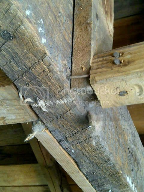

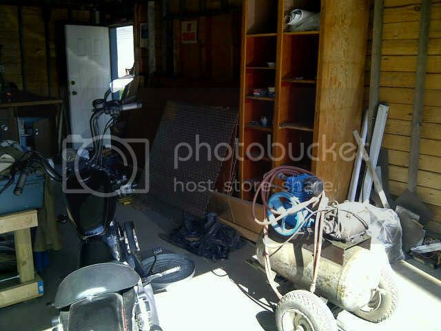

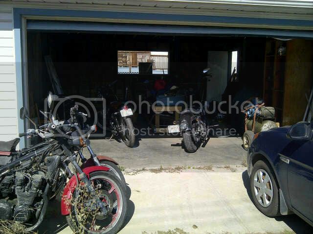

Alright, I thought I'd show you guys why I don't ever seem to post any projects. :p Apologies in advance for the crappy cell-phone photos. Right now I'm working on my garage, getting it up to snuff to use as a shop. When I bought my house the garage had a couple of incandescent bulbs and a couple of 110 outlets run by one shitty old cable buried under the ground coming from a single breaker. The walls were covered in stained plywood (the kind that if it sets on fire it burns like CRAZY) and filled with leftover building materials (paper, ceiling tiles, bits of wood and plywood, etc). There was a gas-line that had been disconnected in the house, and an old leaky bit of b-vent where an old floor-mounted heater would have been. There was also one big uninsulated window, a broken garage-door opener (the plastic gear stripped out) a work bench made by putting a solid-core door on top of a couple of falling-apart old kitchen cabinets, a damaged and pieced together overhead door, a man-door that didn't like to close...
It was a mess. Not to mention that the structure itself was a mess as well. The garage was built out of scraps that hadn't been used on other build-sites (The PO was the original owner, and built several houses in the area) including big rough-hewn beams that didn't make it across the span of the garage, so they were held together by single pieces of non-dimensional wood, old cribbing-material as studs and in the roof, and all kinds of random bits of split, broken, non-dimensional wood as the bracing in the ceiling. This would not do at all.
Notice how out of square the one beam is here, and it's two parts are held together by nothing but that little scrap of wood at the bottom of the picture:
So a couple of years ago I started to tear into it. Even now the further I get into this garage project the more astounded I am at the fact that it has stayed standing all these years. It all started by tearing everything off of and out of the walls and ceiling, and then shutting off the breaker to the garage. Ripping everything out meant that I had a few VERY overloaded trips to the dump in my future...

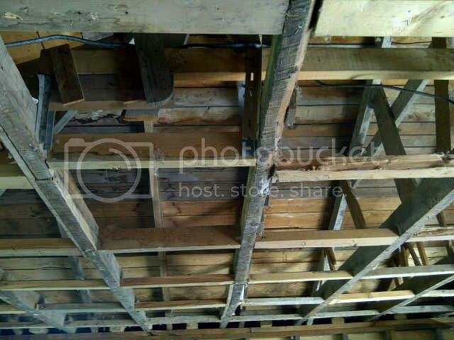

After a long while of making-do without I finally have power again, which is allowing things to move forward much more quickly. Which is good because the next task was a big one: Time to fix my roof structure. The bottom of the beams were not even with each other which would have made drywalling a nightmare, everything needed to be strengthened and straightened, and hell, while I'm at it why not make myself a bit of a storage loft? Off I went...
Used string to make everything nice and flat, and then...
Sistered every beam with 2x6 across the full length, and the back side has a 2' piece of 2x6 at every spot where two chunks of beam meet.
I don't have pictures of what I did for the rest of the roof-structure, but let me tell you, it is solid. The beams and teleposts are long-gone now, and a chain-hoist hung from 2 rafters helped me unload 900lbs from my truck the other day, and didn't even creak. At this point I'm ALMOST done insulating the ceiling (R22 Roxul), the gas-line is hooked back up and pressure tested, and...

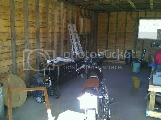

Oh yes, there will be heat. I also have a new man-door installed, and a new opaque insulated window in the back wall. I can't watch the dogs in the yard, which makes me sad, but on the plus side people can't peek through and see the motorcycles, tools, etc.

Just took this picture this morning. Insulation in the ceiling is almost finished, just need to do the very front and very back. You can see I'm going to have two hatches into my loft storage space. Hoping to get started on the vapor barrier this weekend and maybe hang a couple of pieces of drywall during the week. I just need enough up to install the heater and then I can spend the rest of the winter working in relative comfort and hang the rest of the drywall as time allows.
