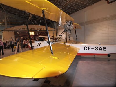

Hi list, been meaning to post some of this on our Vickers Vidette replica built for the Western Development Museum by our Vintage Aircraft Restorers group. The WDM head office in Saskatoon commissioned our VAR group to build same basically from scratch meaning very few detailed drawings and parts. So here starts my story, the Vickers Vedette was designed in Montreal at the Vickers Marine plant which later burnt down and this is the reason few of the original drawings didn't survive.

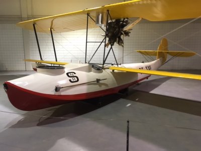

As mentioned earlier the Vickers Vedette all 26 of them was built in Montreal between 1926 -1935 for the Canadian government basically for maritime patrol after WW1 and forest fire surveillance. When the air force decided they were through flying same they were handed over to aerial mapping department of Canada who flew them across northern Canada photo mapping from the front of the aircraft. These photo maps are still used today. After the mapping section was finished with them what was left were sold to the Provinces as fire patrol observation platforms. Province of Saskatchewan bought five of these aircraft for $1.00, that's where our replica aircraft call letters CF-SAE story becomes interesting. One summer while CF-SAE was flying out of Sandy Bay in northern Saskatchewan she flipped over on her back by strong winds. The pilot told the engineer sitting beside him to bail out which he did followed by the pilot. For whatever reason the engineer's parachute didn't open, the bird crashed starting a forest fire with the pilot surviving. I'm told the pilots grandson resides somewhere in Alberta. That's me stand in front of the nose section with the glasses and former members of the group.

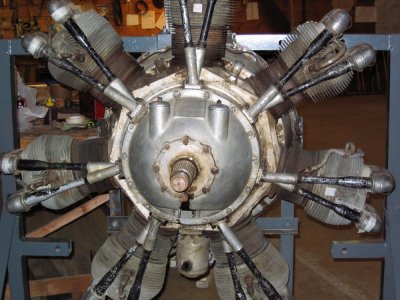

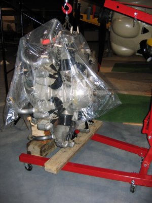

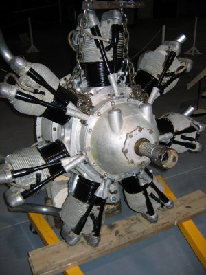

Our engine was a variant used as a replacement in later Vedette's an Armstrong Siddeley Lynx which I believe was recovered from a river somewhere in northern Saskatchewan. Because I was designated the engine guy which was a huge mess it required being brought up to museum standards meaning all cylinders completely drained of oils and fuel, plus the fuel pump, fuel lines and carburetor basically due to insurance and fire marshal. I had a hell of a time doing that without any BSF/BSW wrenches. Exhaust pipes were made by a local muffler shop. Basically everything was touch and go right from the beginning meaning measure, remeasure then let someone else double check ones numbers.

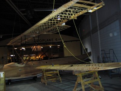

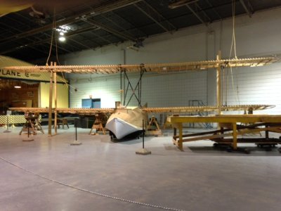

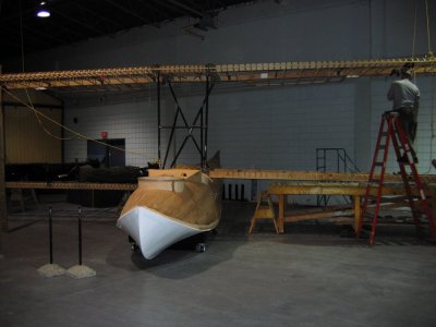

The bare bones frame was assembled and disassemble several times to ensure everything was correct also to measure the stainless steel cables for all controls plus upper and lower wing structures. You can see our build hangar in behind the assembled bare bones frame because the Vidette is much too big for same. Became a nightmare for us at times. original Vedette's were covered with linin then doped over with paint. Our replica is covered with modern day Ceconite a material which is used on home built aircraft of today.
SNR on the front nose of our Vedette stands for Saskatchewan Natural Resources who were tasked with flying them.

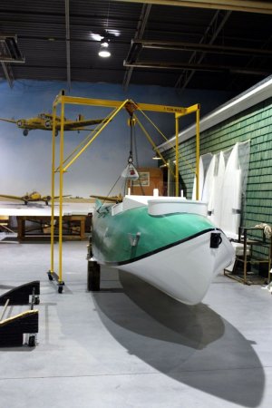

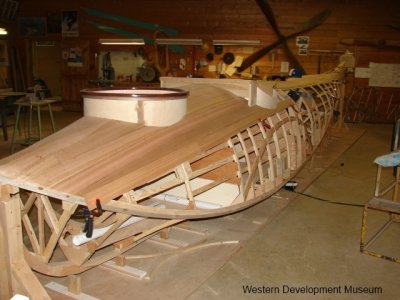

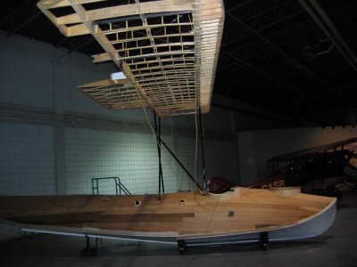

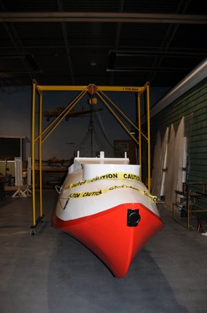

For whatever reason I cannot get the only picture of a drawing to load. Any way here's the mostly cedar wood fuselage hanging on the gantry I designed and built. Had a professional welder do the welding and yes it will lift much more than a ton.

Our engine was a variant used as a replacement in later Vedette's an Armstrong Siddeley Lynx ....
Wow, quite the story. Well, its in a better home now. Was the engine run up or the prize was just getting it back together again?

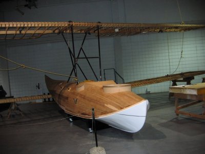

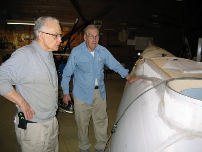

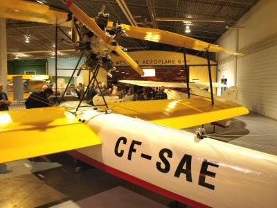

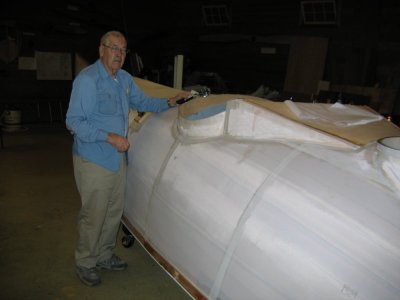

Additional photos for the Vickers Vedette enthusiast. Our Vedette fuselage at different stages of construction and yes it is covered in cedar strips like the original before being covered with the Ceconite material. Once the Ceconite was glued on and dried it was heat treated sometime with a hand iron or hand held heat blower (like those used to remove paint) which tighten the skin like a drum.

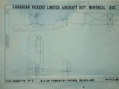

Photo copy of an original Vickers Vedette blue print, believe we only had but three drawings although they offered us much detail. The engine was kept to its original patina after cleaning and ready for installation. Note the exhaust pipes made by a local muffler shop with the engine sitting beside our Anson bomber (trainer). A Sandy Bay Vedette in the far north sitting at rest close by Island Fall dam which is somewhat north east of La Ronge. Besides forestry patrol Vedette's were also used to transport RCMP in the far north. From the last photo (lower rear) you can see the rudder with our build hanger in the background. Flying controls are very much functional although they have internal locks for safety. Museum exhibits are basically roped with warning signs to keep out and hands off. One summer afternoon I arrived at the museum to do some shop work and found two museum guests (Chinese ladies) sitting on the wing of the Vedette having their picture taken. When ask to step down they pretended not to understand even after my pointing to our warning signs.

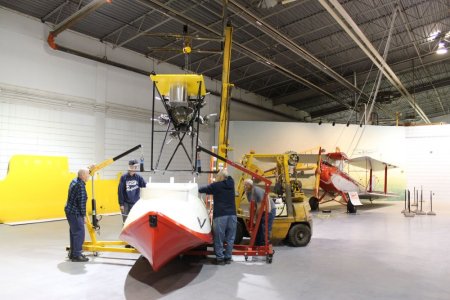

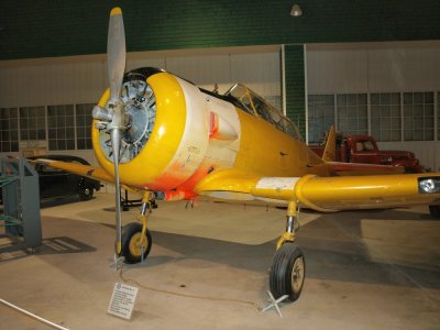

Photo of our Anson and Harvard and the nose section of an Airspeed Oxford sitting in the museum lobby allowing children time to practice their hangar flying skills. LOL
Visit our WDM here in Moose Jaw should you be passing by, lots to offer and you won't be disappointed.
One of the model engine builders from UK forum scratch built a 1/3 scale model of one of its cousins.
https://essmee.org.uk/pre2018/?p=782
The engine never ran after being recovered from its watery grave from somewhere up north. Fact being Peter we're looking for a test pilot with water skills, interested? LOL
