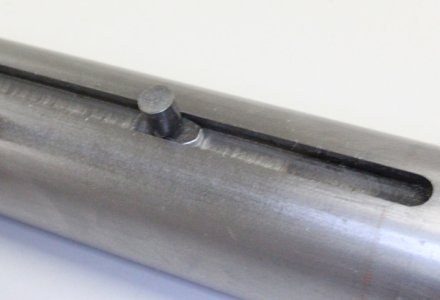

Another item to check is the keyway slot on the quill (I had an issue on the with a R8 holder) look for a bright mark or slight pinch. This can happen during manufacturing or some miss handling by an operator. If there is a bright spot or pinch point, just touch up lightly with a file.
I would highly discourage you from altering the quill or block without eliminating other sources of friction or else you risk creating more problems for yourself. My 14x40 started to develop some intermittent slop & stickiness. The issue was the POS retention key and its fit within the quill slot. I've seen examples of lathes which are even cruder, not a sliding shoe but a set screw which can chowder up the keyway slot, raised burrs etc.

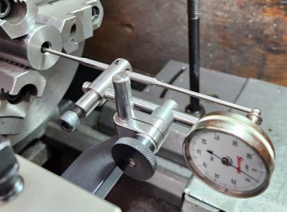

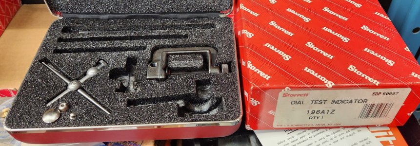

I made a new indicator arm so that I could go deeper into a bore. With the original I was only able to go about 1.5" deep. With the longer arm, 3.25". I use this set up to indicate front and back of the inside of a tube held in a spider chuck to make sure the tube in concentric with the axis of the lathe. The ball at the end of the rod measures 0.180".
Yes, there's a certain amount if flex, but it doesn't matter, I just need to have zero run-out front and back.
And it's funny, Starrett calls this a Dial Test Indicator!

Yes, yes, I have the same assembly, so its not unknown to me. Maybe I should have included a word like 'unaided'.
Its a lever accessory. And like a regular DTI, If you alter the pivot point, it similarly does not measure the amount indicated on the dial. So Starrett labeled it correctly IMO :)
