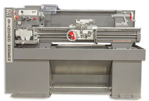

My standard modern 9" Utilathe came on a sheet metal stand from the factory. The 10", 11", 13", and 14" Standard Modern models came the same way and still come this way AFAIK.
I dont see anything wrong with a 'sheet metal' stand as long as its of teh correct gauge and designed well.
What are you suggesting if a person was to buy a NEW Standard Modern 1440 lathe like pictured above (or any other 14" lathe on the market today)? Remove it from the factory engineered base and fab something of your own? The SM 1440 weights 1800lbs.
You clearly arent thinking this through....
I'm not suggesting anything, just telling what I did for my 280 x600 lathe. I don't have an SM 1440. You do what you like with it.
You clearly are misunderstanding what I've said and what this thread is about. Read the original, first post, look at the lathe, does it look like a new, modern, SM1440, 14" lathe?
