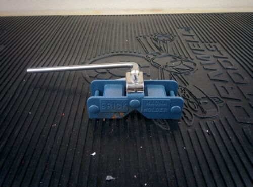

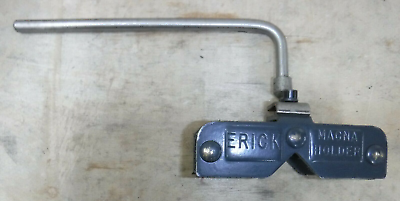

I had as close a look as I could find on the Erick holders. They look very good and are reasonably affordable. There is a fine horizontal adjustment model and a fine vertical adjustment model. I found a video on the horizontal model.
What both are missing from the US General 387 is the swing feature that swings the indicator out of the way, and then allows it to return to battery without additional setup. That's what really caught my eye years ago.
On the US General, you loosen a small thumbscrew, pivot the indicator arm, and tighten the screw. Fine adjustments are made with another thumbscrew. It's the swing feature that I'm after.
If you watch the video below at approximately 5:50, you can see it in action.

This behaves like the one Joe is using: https://clmi.us/product/erick-magna-holder-200m/
Gerrit
Yes, I looked at it and figured that is the one I would get if I got one. It just doesn't have the stop for a hard "return to battery" position and uses a friction ball instead.
But I'm pretty pessimistic about ever finding a US General 387, so maybe I should just quit pouting, buy the Erick, and maybe think about how to create a swing stop for it.

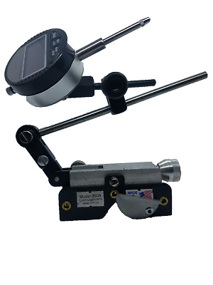

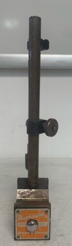

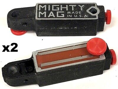

@Susquatch : Here are some that may appeal to you:
I think your 4th suggestion is what I will probably get except without the indicator. (I do not like digital indicators.) That is the horizontally adjustable Erick holder that @gerritv was suggesting. But I might get the vertical version too and then get to work designing and building something that does both as well as having a return to battery provision. We will see. Just need to find away around those outrageous shipping charges.
I have several versions of the Mighty Mag holders and a few of the regular magnetic post holders already. It's that return to battery position that has had me all hot and bothered for a few years. Just slap it onto a quick change tool, make a measurement, flip it out of the way without losing calibration, make a cut, flip it into position, make a measurement, flip it back, make a cut, etc etc. I really like that. But it may not work as well as I imagine it in mind so we will see.

I just looked at Joe's video again, there is no 'return' position that you keep mentioning. Can you point me to where you see that? The 387 is no different than the Erick Magna one I linked to, except the 387 is crudely made.
Gerrit
Gerrit
Hmmmm. I could swear I remember seeing that. But I've now looked at a number of photos and videos and I don't see it either. Must have been a brain fart or my imagination at work again.
So that said, I would really like that feature. So it looks like the Erick holder is the way to go for sure!
